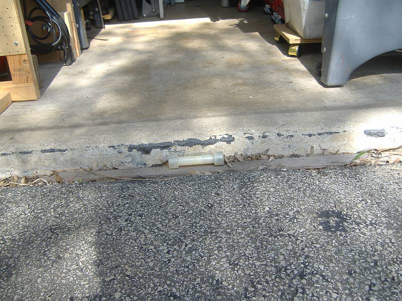

First I'd like to show you what I face when I have to take my shopsmith outside to work. The driveway has sunk by about 2" and pulled back from the concrete. It is hard to see from the picture but that is what the situation is.
[ATTACH]16973[/ATTACH]
I built a ramp to solve some of this issue.
[ATTACH]16974[/ATTACH]
You can only guess what the rest of the driveway has to offer...
Even with the bigger wheels this is not going to be a case of the shopsmith rolling off to smoother pastures.

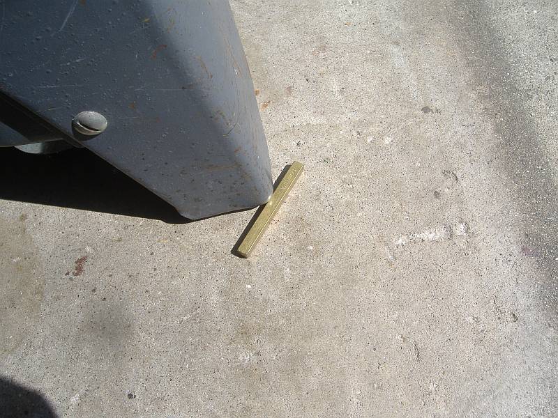

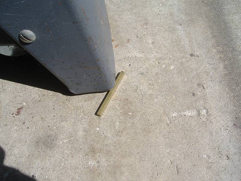

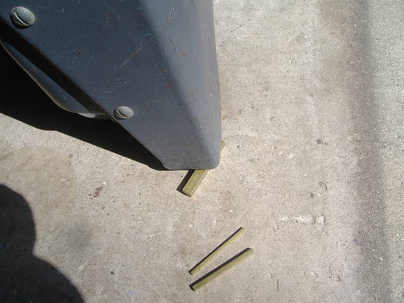

Remember when we were told that we got a 1/4" lift then a 1/2" lift as you raised the machine?
So I should see this on my stock 1976 model machine with all factory parts right?
Alright both legs in the first position on a smooth concrete floor.
[ATTACH]16975[/ATTACH]
Using brass bars to measure a 1/4" is not even close to going under the leg. I then used a 3/16" and it went farther but still not enough to say the leg was clearing even that.
[ATTACH]16976[/ATTACH]
Any better at the second position? No, the 1/2" bar is a no-go.
[ATTACH]16977[/ATTACH]
A 3/8" bar does fit with just a little wiggle room.
[ATTACH]16978[/ATTACH]
I'll let you think about that for a while.
Next I wanted to see how high off the ground a wheel would be when the machine is sitting on the legs. Turns out it is just less then 1/8".
[ATTACH]16979[/ATTACH]
The wheels are still in pretty good shape but it could be they are worn that much??
