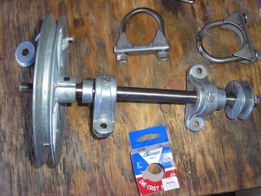

I needed
2-2 inch v belt pulleys
2-7inch pulleys
1-mandrel or axel and 2 pillow blocks
[ATTACH]17066[/ATTACH]
[ATTACH]17067[/ATTACH]
[ATTACH]17068[/ATTACH]
[ATTACH]17065[/ATTACH]
This would all attach to the board shown later which drops below the bench tubes.

So what next..
The old diagram shows to drop a board below the bench tubes which will also allow you to tension the belts.
Here's a mockup. The sequence is a 2 inch pulley on the headstock to a 7 inch. The 7 inch is on shaft with a 2 inch, back to a 7 on the bandsaw.

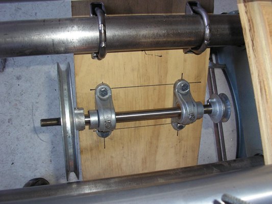

Here's a mockup of the lower jackshaft. The things on the top of the pillow blocks? Yes those are oilers. A few drops of machine oil and these things will spin forever.
[ATTACH]17069[/ATTACH]

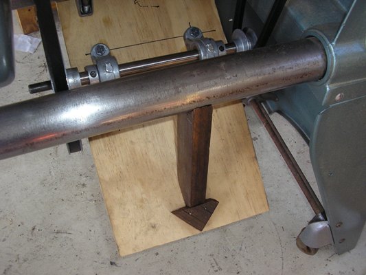

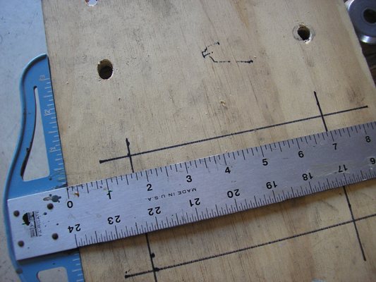

Shot of the hole spacing. Now the board is held to the bench tube by 2 exhaust clamps. Not tightened tight, but left loose to allow the board to drop away or swing up.
[ATTACH]17071[/ATTACH]

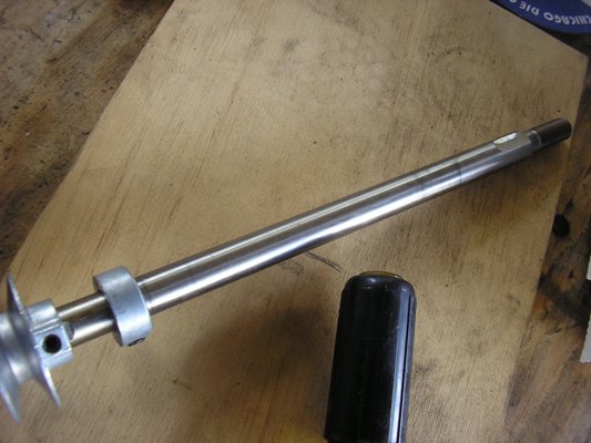

Last is the ground section on the right which was ground to accept the 7 inch on the mandrel with the 2 inch.
Up to the pulleys on the headstock and bandsaw.
[ATTACH]17070[/ATTACH]

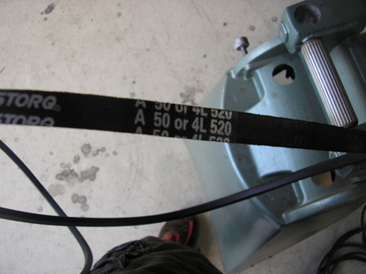

So now you have tried to space the jackshaft on the wooden board. Make sure the jackshaft is centered when the tension is applied. I have some measurements coming up that will allow you to work off mine if you want. If the jackshaft is not centered the belts will ride the bench tubes.
You will need 2 belts. Here is the belt size you need:
[ATTACH]17073[/ATTACH]
Belts bough off ebay seller compressor-source for 9 bucks each.

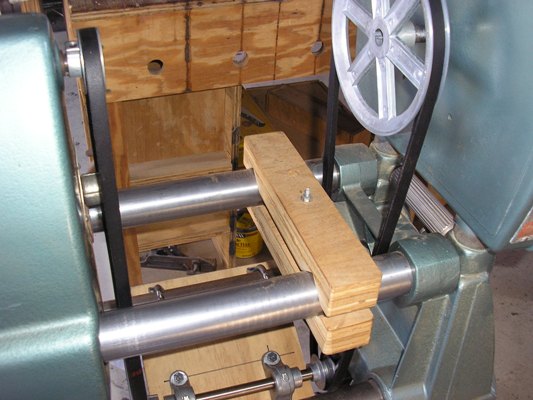

[ATTACH]17074[/ATTACH]
Now to tighten the board I made a wedge that fits between the bench tube and board. This tightens the belts. You will have to play with your setup and I will get around to pics of mine shortly.
[ATTACH]17075[/ATTACH]
Finally the whole rig.
[ATTACH]17076[/ATTACH]
