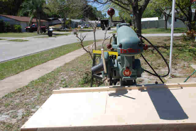

That indeed was a major challenge on my old Dewalt, raising the blade was a serious workout. I went through the whole adjustment procedure from Junckel's book "Mr. Sawdust" and now it seems pretty good, though I've been too busy restoring a shopsmith to do much woodworking. Haven't pushed its abilities very far. I looked at an old Craftsman RAS, beautiful bronze colored one, but as it sat the blade swung a lot, especially in the 45 degree miter postion.robinson46176 wrote: The key on the post is adjustable but if you get all of the slack out there is not enough lube on the planet to allow you to crank the thing up and down. If you set it by the book you can bring the saw (off) out to the end of the travel on the arm and with very little effort you can swing it at least 1/4" from side to side.![]()
TC
I've always had a RAS in my shop. My Dad had a Dewalt 12" when I was a kid, and I used it a lot.
Back in the 70's, I was in the Navy on Shore duty I bought a Craftsman 9". That was all I could afford. Shortly after I got my shopsmith. They complimented each other. When it got time to go back to sea duty, I sold the RAS, and kept the Shopsmith.
I didn't have a RAS, until I retired from the Navy, and moved back to Florida.
I bought another Craftsman. That was a "love-hate" relationship
I got a deal on a 1956 Dewalt "MBF" 9". I did a restoration job on it. I bought a 8" forrest WWI that's made for that saw, asper the late "MR Sawdust".
I couldn't be happier with the results.
