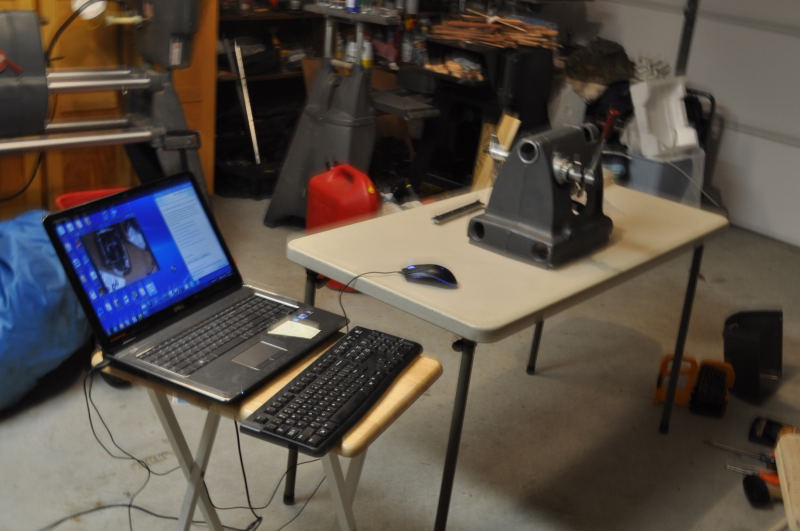

Got my Laptop at the ready with the DVD loaded and ready to go.

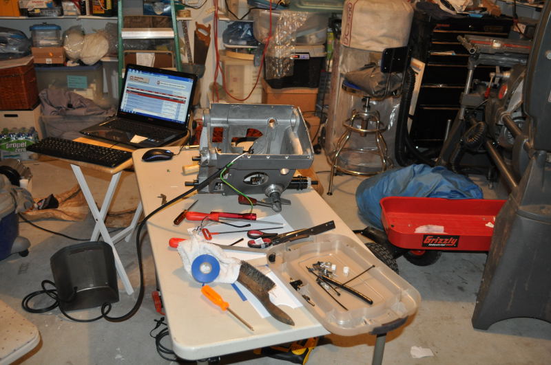

Got all the new shafts installed and ready to install the motor

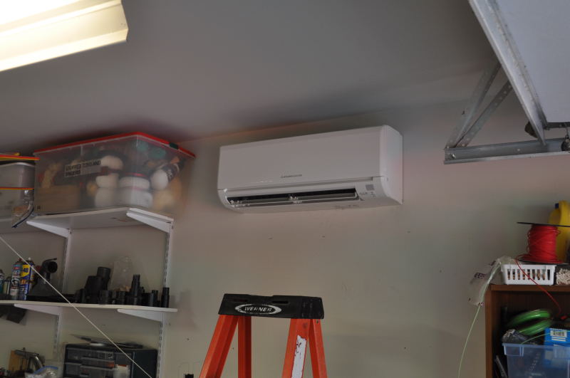

My new Mr. Slim Split Air Conditioner pumping out 15,000 BTU's of cool air. It's over 100 outside and a cool 78 in my garage.

Fred, you said it took you 10 hours, but would you call it challenging? I'm looking to do a DIY PowerPro upgrade when I have a chance.
Also, did you install your AC unti yourself? I'd like to do something like that to my garage.

I felt it was not too difficult. Now that I have done one I probably could do the second one in 2 or 3 hours, not counting time taking the old parts out. I took it slow and easy because I didn't want to make a dumb mistake, because that might be painful, money wise :eek: I would recommend buying a tap and die set, to clean out all the threads before they become cross threads. It really helps if you have access to the dvd while you are doing the work. You will be stopping and backing up many times to re-review the instructions. It really helps if you clean and wax all openings before installing the new parts. The only thing I did differently was to expand the new power cord hole with increasing sized drill bits instead of using a rat tail file. I probably saved 30 minutes. Just don't rush it, take your time and enjoy the learning process. You will have a much better understanding of how things work under the hood after this project.
I would also have a shopvac available to suck up all the metal filings you create before they have a chance to fall into the interior of your headstock.
I blew 20 bags of insulation into the attic above the garage and installed insulating panels from Lowes to the inside of the garage door. The A/C is a 15,000 btu Mr. Slim and is a split system which was installed by two professionals in 3 hours. Google Mr. Slim.
