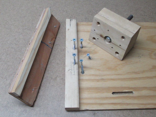

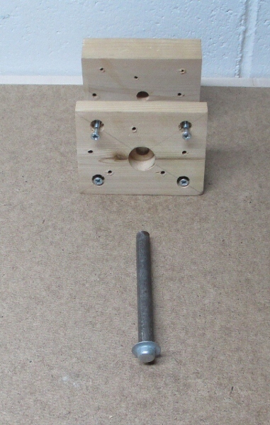

After determining the angle needed for fastening the mounting the axles, the axle mounts were made.[ATTACH]18143[/ATTACH][ATTACH]18142[/ATTACH]
Yes that is the bevel cut that was discussed in an earlier thread.
In the second picture the lower bracket, with its foot removed, has screws in place to attach the axle mount.
The next picture shows the upper and lower bracket halves wit the axle mounting block attached to the lower half of the bracket.

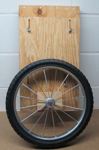

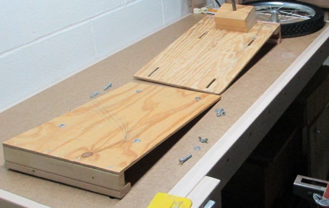

Next are pictures of the assembled bracket. These “dry fit” assemblies were mounted on the boat to check out the wheels' angle when mounted. The angles were fine, but found that the slots needed to be lengthened and the lip of the upper bracket half narrower.
[ATTACH]18140[/ATTACH][ATTACH]18139[/ATTACH]
The whole thing was disassembled, corrections made, and put back together...this time with glue. The axles were epoxied in the axle mounts and the bolts (machine screws actually) going between the bracket halves were also epoxied into the upper half brackets. (continued in next post).

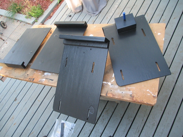

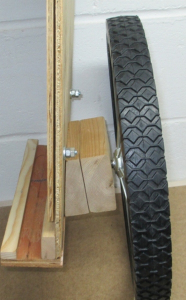

So a little paint and done!
[ATTACH]18145[/ATTACH][ATTACH]18144[/ATTACH]
In the second picture one bracket is extended, or open, and the other is closed.

Where there is a will. . . .saminmn wrote:So a little paint and done!
Sorry, no pics yet of the boat loaded up and headed to the water:D![]()
