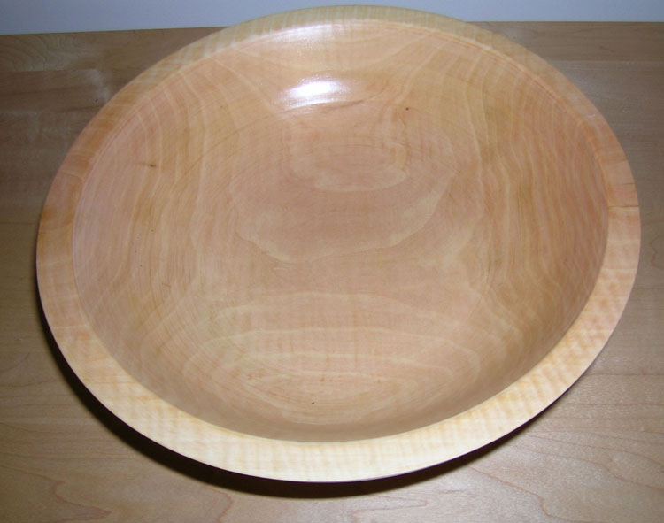

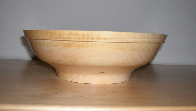

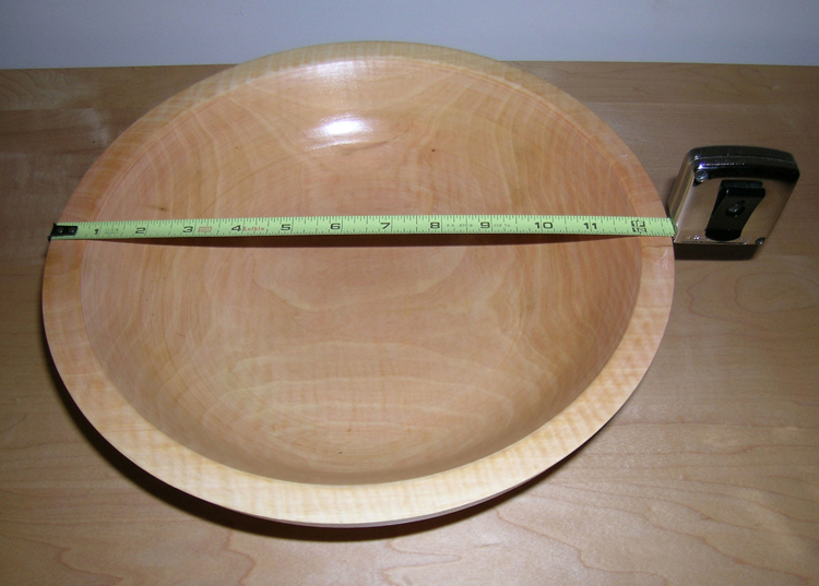

Well, I've finally started to try my repaired Rotator Cuff on the Right Shoulder. I went to turn a bowl at my mentors house, and it was fine (shoulder that is). [ATTACH]18322[/ATTACH]
[ATTACH]18323[/ATTACH]
[ATTACH]18324[/ATTACH]
This is Bradford Pear harvested about 2-1/2 months ago while arborists cut down 4 trees near the house, and measures 12.75 diameter x 4.5 " tall. It has since gone oval 12.75 x 12, but stayed flat top and bottom.
