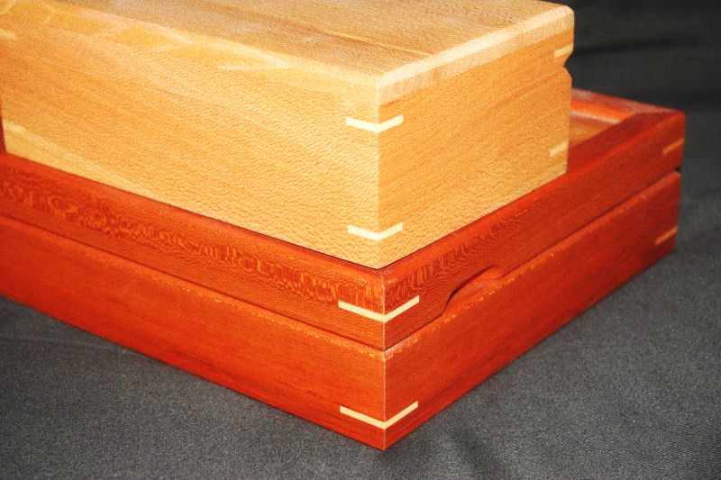

I've not turned sycamore, but I have used it for making boxes as it has has a lovely lacy grain pattern when quarter sawn. The upper box in the attached photo is quarter sawn sycamore. The other one is cherry.

[ATTACH]18346[/ATTACH]
