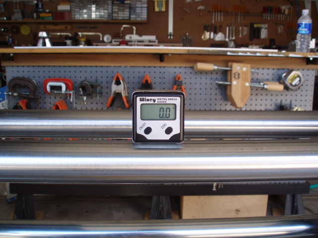

Today, after moving the Shopsmith all over the shop looking for a new location, I decided to check the way tubes and the bench tubes for level.
I also checked the bench tubes with the Shopsmith in the drill press mode.
Guess what, they change somewhat between drill press and table saw configuration. I was actually quite surprised. Nothing to be alarmed about but they do change. My tubes change as much as .1 degrees just checking them at different locations along the tubes. My rear tube changes more than the front tube.
I momentarily thought about the lift assist. Does the lift assist change them at all. But I decided not to do that. Since it is all working I decided to leave it that way.
That all being said, I also learned that the Wixey is sensitive to front to back attitude as well as side to side.
With the Wixey magnetically attached to the way/bench tubes, you will get a reading (end to end). If you push the Wixey around the tubes just ever so slightly, the reading will change. In other words, the Wixey must be sitting directly on top of the tubes to give an accurate reading.
It is not quite as versatile as I thought is was. A bullseye level may be more versatile though not quite as accurate.

Stick with the Wixey
Dusty,
Stick with the Wixey, and do not worry about .1 degree on the Way Tubes. Any concern should only be focused on the table to the blade, etc. It is this area that actually determines your final cut, final drill hole, etc.

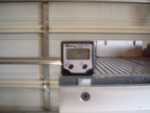

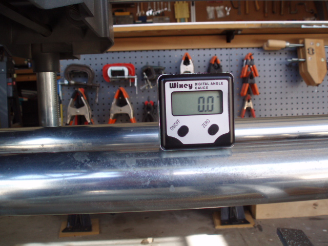

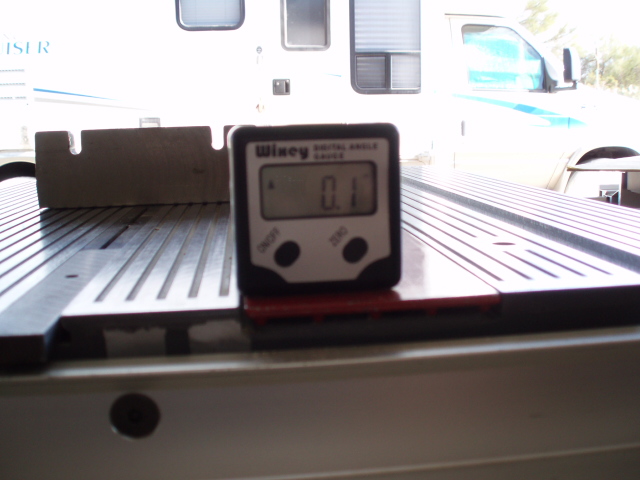

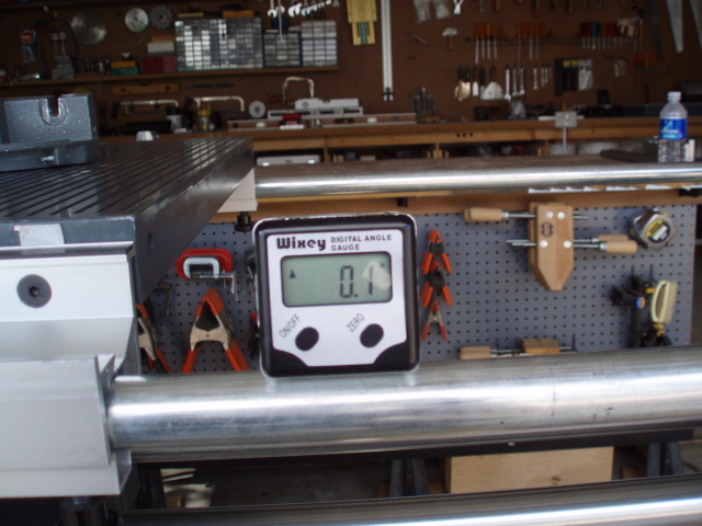

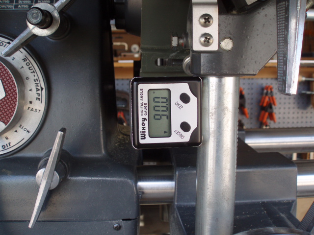

Wixey Angle Indicator
being used to confirm Shopsmith alignment.

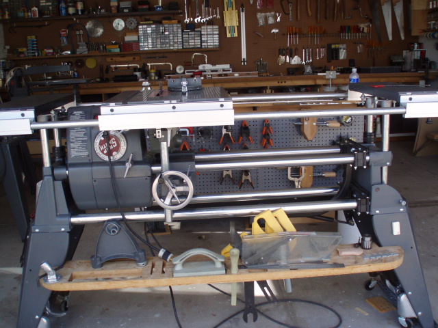

I have returned my Shopsmith to a standard 520 configuration with two extension tables. My extension tables have been identified, for data collection purposes, as right extension and left extension.
The pictures will speak for themselves.
There were NO adjustments made prior to taking these photos other than main table height.
The Lift Assist is installed and shall remain so.
There will be two additional sets of pictures to tell the entire story.

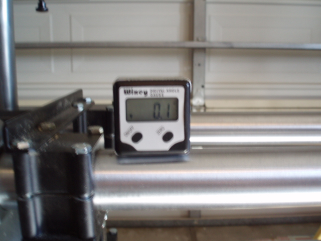

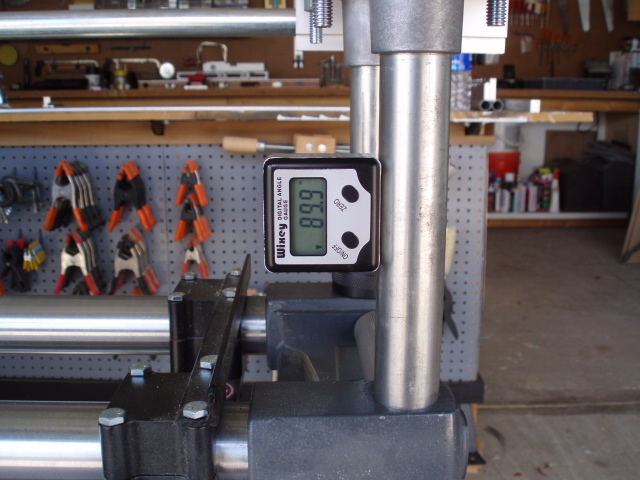

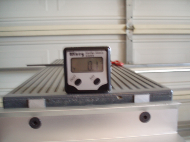

The second set of photos.
After these photos, I will take a few to show how changing tables effects alignment.

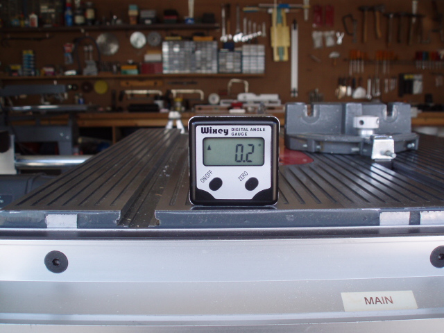

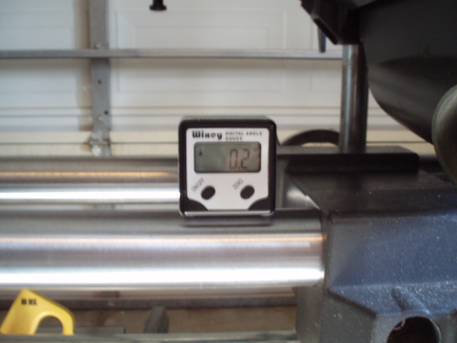

Wixey Angle Gauge
The final photos will be delayed at least until tomorrow.
I have many additional photos but they are just more of the same.

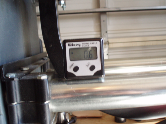

My conclusions: The tubes are level to within .2 degrees and the tables are level. This Shopsmith is ready to make sawdust.
The one reading that should catch your eye is one .6 degree reading which is being taken with the Wixey on the way tube, right end, back side. This tube is attached to the lift assist. No conclusions to be drawn yet. I will later take a set of readings to determine if anything changes with the lift assist being used. I am not going to detach the lift assist. I see no point. I regularly go into vertical mode and back and have NO problems.

Dustydusty wrote:The final photos will be delayed at least until tomorrow.
My question to you is now that everything is set up can you or can you not swap the aux tables? If not, do you have any idea why not? If not can you use your wixley and see if the table goes off level or the legs less than vertical or exactly where the error comes from?
I know my aux table swapped perfectly when I had my original 500 setup. After I got the 510 upgrade I noticed my table bound as I tried to slide into the left side holder if everything else was perfectly aligned. If I loosened the table from the legs and then tighten them they slide up and down perfectly but when the table was moved to the right side the alignment was off. If I adjusted for perfect alignment and move the table back then the legs bound.
People on this forum and others have told me this is normal but frankly I don't buy it. It might be normal for most machines but from the stand point of design this seems to point to something wrong somewhere.
