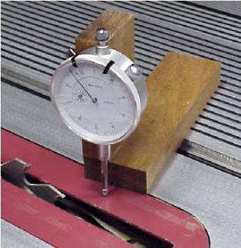

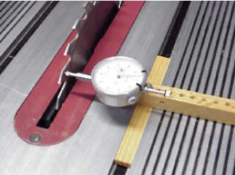

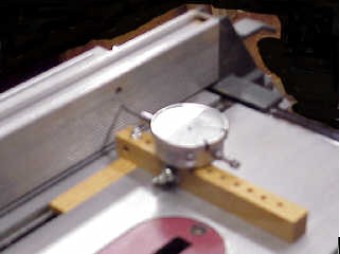

Why buy one when you can make an alignment jig?
Alignment jig made of hardwood and an inexpensive dial indicator. The above jig, consists of a rail that fits snugly in the miter slot and is bolted to a .75" square piece with holes drilled so the rail can be mounted at many positions and the dial indicator mounted at two positions.
This jig allows measuring the distance to the slot of the blade and fence. When measuring the blade distance, it can be used to align the table to the blade, as well as measure blade, arbor, and bearing run-outs. (Picture 1)
Aimed at the fence, it can be used to align the fence to the miter slot. (Picture 2) By attaching an accurate square to the miter gauge in the second miter slot, it can be used to adjust the gauge to a perfect 90 degrees. Once the fence is aligned, it can be moved to the extension table, and the table adjusted so that the fence is square with the main table. (no picture for these).
The jig holds the dial indicator vertical to the surface. This can be used to shim table inserts to be flat with the table, adjust depth of cut of dado blades, and even adjust the depth of router bits. (Picture 3).
Total cost was less than $5 a few years ago.

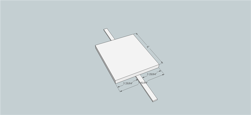

If you want/need a jig that will facilitate a quick and accurate Main Table alignment, make yourself one of these.
I can attest that it works fine and takes a lot of the frustration out of this task. However, to be accurate, it needs to be built with near precision.
[ATTACH]18376[/ATTACH]
To use it, simply install it in a miter track on either side of the blade. If the table is properly aligned, one edge of the fixture will be perfectly aligned against one side of the blade. If not, loosen the trunnion bolts so that the table can be moved into the proper position and then tighten the trunnion bolts.
The principle is very simple and probably obvious to every one. The miter tracks are used as the reference to verify parallelism. The jig simply established that parallelism (with the blade) and while doing so, centers the blade in the table insert cutout.
