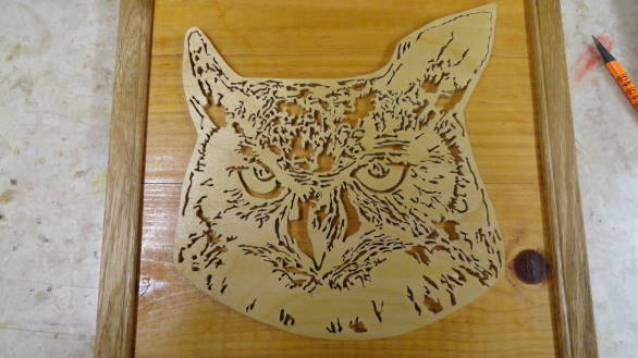

I purchased the scroll sanders years ago, out of the package of 5 I still have one. I really didn't like them. If your scrolling fine work, using a #2 or a 2/0 blade there is no room for that type of sanding, it just cuts out the fine points and sharp angles you have worked so hard to establish. If the openings are large just pulling a thin piece of sandpaper does the job just fine. On outside cuts there are so many options.
Maybe I didn't give the sanding bars enough of a try, but I personally do just as well slowing the blade speed and pressuring the blade against the cut. I have a collection of micro rasps, picked up over the years, and like I said before, I like to slowly pull thin strips of sandpaper, much thinner than the sanding bars, through my fine cuts.
This Owl is a project I just finished as a Christmas present for one of my daughters. I can't imagine using a sanding stick on the fine cuts.
[ATTACH]19514[/ATTACH]
