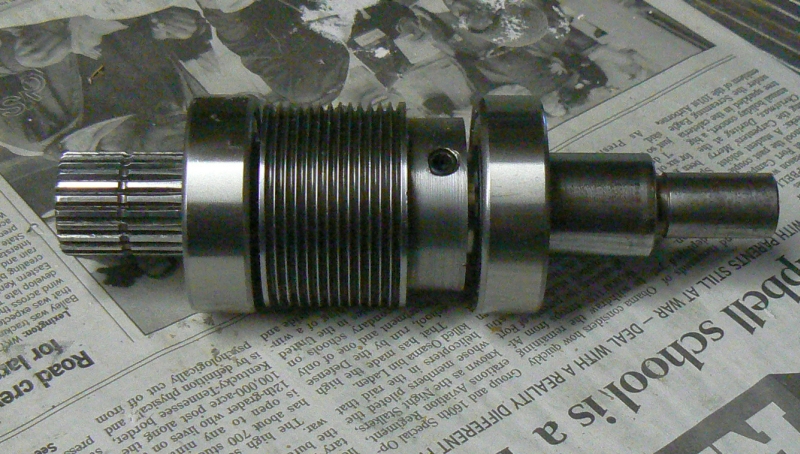

Not much to show here. The poly-v pulley is centered between the retaining ring grooves and tight(very) to the shaft at its original location. The retaining rings are installed in the grooves, and the bearings are pulled onto the shaft up to the rings.
[ATTACH]19840[/ATTACH]
[ATTACH]19841[/ATTACH]

Mark VII Main shaft reassembly
- MAIN SHAFT PARTS.jpg (239.1 KiB) Viewed 2673 times
- main shaft assembled.jpg (359.69 KiB) Viewed 2672 times
