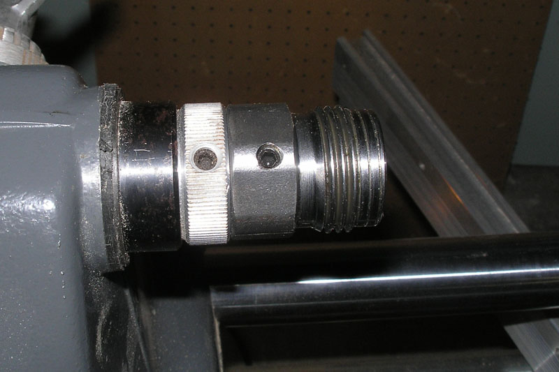

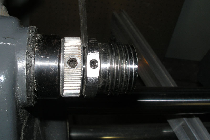

Got my new Nova PN 'ISNS' (i.e. Type S) insert/adapter for my Nova G3 chuck to replace the Nova PN 'IFNS' (i.e. Type F) which was the original one supplied.
I took a few pictures to show the differences. The first picture
[ATTACH]19893[/ATTACH]
shows the two adapters side-by side - the Type F on the left and the Type S on the right. You can readily see that the hex shoulder on the Type S is much thicker than the one of the Type F (in fact, I measured 0.369" on the F and 0.754" on the S). You can also see (sort of), by the 'leaning' of the hex wrench, that the set screw is at a slight angle. The set screw is also larger and now matches the rest of the screws on the SS (hurrah!).
The 2nd picture
[ATTACH]19894[/ATTACH]
shows the Type F on the Mark V's output shaft. Notice that the adapter does not fully seat at the end of the shaft. The next picture
[ATTACH]19895[/ATTACH]
shows the Type S - it does fully seat. The last picture
[ATTACH]19896[/ATTACH]
shows the new adapter and the G3 all mounted and ready to go. Overall a nice improvement and applause to the folks at SS who obviously saw a problem and addressed it.

algale wrote:My adapter is the same as Dusty's. I bought it May 2011. I called Teknatool and they are shipping me a replacement adapt too. Here's the kicker: they advised me not to use the chuck again until I get the new insert. I suspect the angle of the set screw is the issue.
bobgroh
- Posts: 400
The Amazon listing does indicate down the page that the Teknatool item is their PN ISNS which is, indeed, the part with the larger shoulder, bigger set screw and the angled setscrew. The older type F (i.e. Teknatool PN IFNS) certainly does work (as many of us can attest) but the type S is more substantial and, IMHO, a worthy update.
If I was buying a Nova chuck for my Shopsmith, I would certainly insist on a ISNS insert.
Regarding Teknatool and Shopsmith replacing type F's - they certainly did and will IF you had purchased a G3 from Shopsmith or directly from Teknatool fairly recently (Teknatool and Shopsmith were a bit fuzzy on the actual cutoff) - the number of 6 or 8 months was told to me by the folks at Teknatool in Florida.
Don't know whether any type F's were ever provided in the 'S' format. Don't care. Physical inspection is the name of the game. Part of the reason why I provided the pictures. And, yes, I was aware of the previous thread and watched it closely while I figured out what to do.

Regarding the original photos in this thread, the one with the "F" adapter with the gap between the adapter and the Shopsmith aluminum keeper, the Nova G3 owners manual states that "the chuck body must contact an accurate register on the lathe, either a shoulder on spindle or bearing face etc to ensure chuck will run true. If further modifications are needed (e.g. spacer) these are the responsibility of the user."
