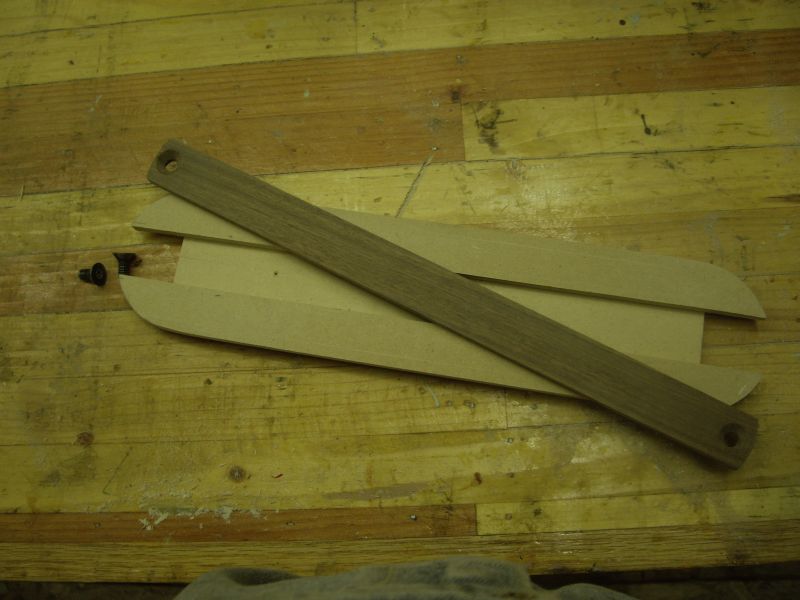

For my 500, I made one with changeable inserts. The base part is MDF. Probably not the best but it was a proto. In use for 2 years now, though.

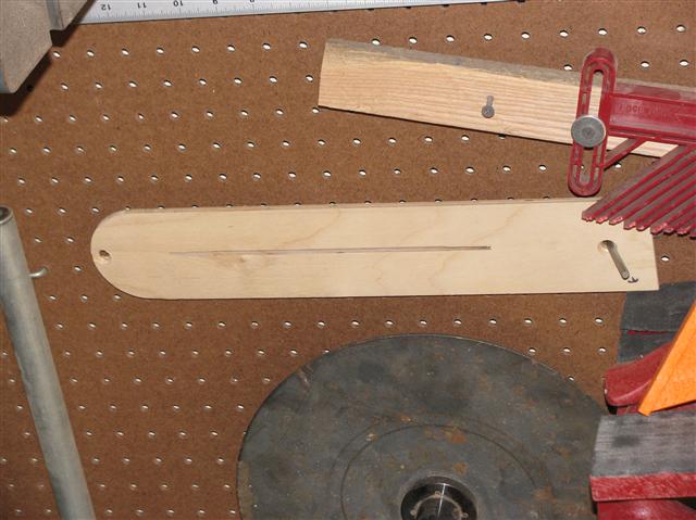

Made 5 or 6 of them quite awhile back when I had some free time and some BB cut-offs.
[ATTACH]19955[/ATTACH]

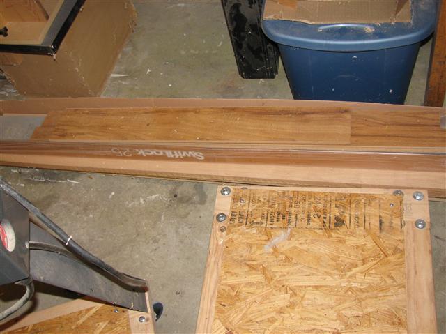

For the next round, I plan on using these laminate planks left over from a flooring project.
[ATTACH]19956[/ATTACH]
I rough-cut them on the band saw and use a pattern bit in the router to cut to final shape...using a standard SS insert for the pattern.
Not only do they keep slivers and cut-offs from dropping inside, and reduce chip-out on the bottom; they also seem to make dust collection work better.
