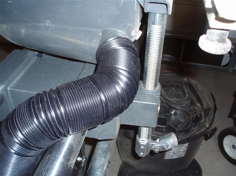

I have always been frustrated with the hose (and elbow) that I have had attached to the lower saw guard. It interferes with the table uprights if I want to move the carriage or headstock with the dust collector attached.
No More!:) I think. I have had the solution installed only one day but I think it is going to work.
I bought only the hose because I did not need all the other parts in the package shown in the ad.
The hose attaches directly to the dust port on the saw guard. No elbow required.

dusty wrote:I have always been frustrated with the hose (and elbow) that I have had attached to the lower saw guard. It interferes with the table uprights if I want to move the carriage or headstock with the dust collector attached.

Dusty,
Pic of how you have this installed Please please please. I hate having to unplug my dust collector house to move the table.

I'll help whenever I can.claimdude wrote:Dusty,
Jack
[ATTACH]20032[/ATTACH]

Nice, I picked up one of those a while back. Great use of it, I will have to try it.dusty wrote:I'll help whenever I can.

I paid $16 and some pennies for just the hose. That translates to the clamp and two fittings costing about $26 plus shipping. BTW, the part number is 556186.charlese wrote:Although I also like Woodcraft You should be aware that Shopsmith has the same flexible yet rigid hose. It also comes with a hose holder and companion clamp. It is a wonderful tool to use with drilling, routing and turning. The clamp and hose holder allows a plethora of uses.
Stay put dust collection system......part 556168 .... $42.59 Pay a little more and get a little more!
Another note/question - I have never used an elbow on the lower saw guard and never had a problem with it.
I'm glad for you that your set up works so smoothly. The hose and/or clamp caused me grief so I eliminated them as seen in the photo image.

Dusty,
Thanks for idea on flex hose. I ordered mine from Woodcraft.
The fit is difficult. In fact, I can't get the flex hose to go over the lower guard. Did you have fit difficulties?
I'm open to suggestions for getting a successful fit.
