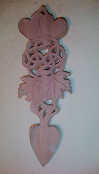

This is a spoon blank cut out
[ATTACH]20236[/ATTACH]

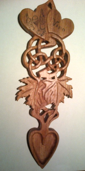

and this is the finished spoon
[ATTACH]20237[/ATTACH]
