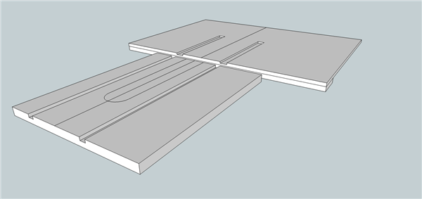

If you haven't already acquired something to serve as an outfeed table, you need to consider this.
**OR**
Build one that rises and lowers and tilts with the main table.
[ATTACH]20502[/ATTACH]
**OR**
- Outfeed Table, 2013 Version with Main Table for Relationship (Custom).png (37.31 KiB) Viewed 4718 times
That is good. I believe an outfeed table is an absolute necessity when ripping anything that extends beyond the outfeed edge of the main table. That support out there helps to maintain control of the materials being cut. The effort required to hold the stock down on the table is much less. It is when the stock lifts up off the table that many kick backs occur.ryanbp01 wrote:I purchased the one advertised by Shopsmith for the 520/Mark VIIand really like it!

I have watched the video link on the page of the out feed table promoted until March 7th and it does not look the same. I would prefer the one promoted on the video which seems much better for different situations.

The thread is there; I'll look for it and post a link.camerio wrote:I have watched the video link on the page of the out feed table promoted until March 7th and it does not look the same. I would prefer the one promoted on the video which seems much better for different situations.
Dusty, is your design adapted for bevel cuts ?
I kind of remember a thread where you were showing us your out feed table ...
but I could not find it !!!???
Is it adapted for bevel cuts? NO but it easily could be. My previous sled was in that I had included a miter track like the one Nick used and I had an extended fence that would support the outfeed.
Shopsmith has not promoted the fence that Nick introduced on the Sawdust Session. I don't know why but, in my opinion, they have missed the boat.
Being able to raise/lower/tilt the table without fussing with the support leg is a real blessing and worth every penny it might cost.
Word of Caution: Cutting bevels with the tilting table could be real hazardous. The materials that are on the high side of the blade WILL tend to side downward into the blade. If that is allowed to happen, you WILL eventually experience some sort of kickback or throw back. To minimize that, I attempt to keep whatever is on the high side as small as possible. Even then, it can come flying at you.
