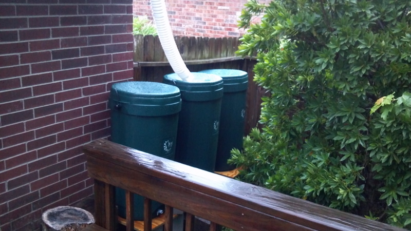

I just installed 3 of the 6 60 gallon rain collection barrels that I received yesterday and last night we had an inch of rain which filled all 3 barrels. I need to go ahead and install the remaining 3 barrels before our next good rain so I will have a fresh supply to water my plants during the next dry spell.
[ATTACH]21716[/ATTACH]
I use a flex downspout and fill the center barrel first, then the overflow outlets fill the other 2 barrels. You can link as many barrels together as you want. The barrels cost $60 each and was part of a special put on by our local water department. Google Rain Water Solutions, Inc to find out where you can get your barrels in your area.

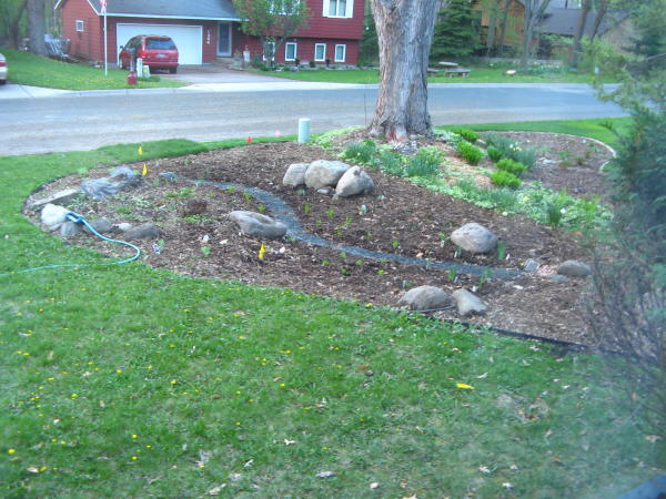

In our area, some Water Conservation Districts are encouraging folks to build rain gardens. The garden pictured is about 12-14" lower than the surrounding area. We have two of these one about 600 square feet and the other about 500 square feet. The downspouts from the gutters run to buried pvc pipe that empty into the gardens. Our sump flows into these too now. All the water used to travel via swails to the curb, to the storm sewer or into Battle Creek and finally the Mississippi. The theory is the water that stays on the property will slowing make its way into our aquafer.
When and why did cisterns go out of style?

Thumbs up on your addition!fredsheldon wrote:I just installed 3 of the 6 60 gallon rain collection barrels that I received yesterday and last night we had an inch of rain which filled all 3 barrels. I need to go ahead and install the remaining 3 barrels before our next good rain so I will have a fresh supply to water my plants during the next dry spell.
Location might dictate the cost. The last plastic barrel we got was $75, so you price seems to be an improvement on what I can get. The one I got was from some overseas import of pickles or olives so in effect these are left overs that they add a couple of parts to.
I'd like to see a couple more pictures of how you did yours, base, how high, how are you getting the water out, etc.
We have a rain garden in the planning phase. A local group has a farm that they have all this stuff set up on, rain gardens, solar panels, wind power, and more. They are a non profit group that does tours, guest speaker type things and will consult with you on the design and plant selection that use area specific native plants.berry wrote:Lots of folks are trying to capture rain water these days.
[ATTACH]21717[/ATTACH]
I'm not sure if this is going to happen this year or next but it will happen in our yard. It is the right thing to do and besides I want yet another certification for our yard.

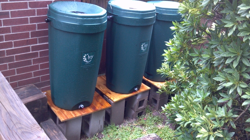

Everything required to collect and distribute the water comes with the barrels. A ball valve screws into the bottom and there are overflow flex hoses to attach between each barrel. The lids are bug and child proof. I was in a hurry so I just purchased some blocks and 3/4 plywood scrap from Lowes and set the barrels up in the hopes that it would rain later in the day, which it did. Not much to look at but it works and it's in the back yard.

Thanks for the extra picture, now I think all is clear. Were you thinking of a three way manifold, one to each barrel so you empty them equally? Or is the plan to empty then as it happens?fredsheldon wrote:Ed,
[ATTACH]21718[/ATTACH]
I would guess intake barrel first, then the adjacent ones.reible wrote:Thanks for the extra picture, now I think all is clear. Were you thinking of a three way manifold, one to each barrel so you empty them equally? Or is the plan to empty then as it happens?
Gonna put the other three hooked up to these?
- fredsheldon
- Posts: 1175
Yes, all 6 will be together. I only installed a rain gutter on the backside of my house. If gravity does not do the job, I will install a boost pump to push the water to the end of the line. I was planning on just moving the hose from barrel to barrel as necessary. Of course my plan may change in the future. This is a trial and error process for me.
