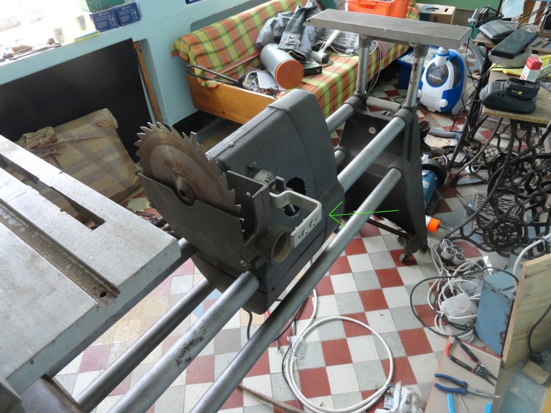

My Mark V has S/N 14931, putting it in year 1978. I found one manual online (32 pages, part # TMG-3469A-84(0)-P-7B*) which seems to describe my Mark V, except for not having a saw blade guard in the manual and the manual shows a gilmer drive instead of poly V.
Is the 101 page Mark V 500 manual that shopsmith sells for $30 going to give me much more info than this one i downloaded?
Also, what is the aluminium bracket on the saw blade guard for? (Shown in attached photo)
- saw_guard.jpg (249.03 KiB) Viewed 2000 times

freedomlives wrote:My Mark V has S/N 14931, putting it in year 1978. I found one manual online (32 pages, part # TMG-3469A-84(0)-P-7B*) which seems to describe my Mark V, except for not having a saw blade guard in the manual and the manual shows a gilmer drive instead of poly V.
The bracket on the backside is for the attachment of the upper saw guard cover. Just for laughs my Shopsmith Mark 5 is number 13906, I bought new on 3/26/1977 for $749.00 . Those where the days !!!

Seems I don't have the upper saw guard then. I only used the table saw once before. In fact, if memory serves me correctly, my SS didn't come with the saw blade or arbor when I was given it, I bought that off ebay, so I guess the upper guard got lost as well.
Is this what should attach to it?

[quote="freedomlives"]Seems I don't have the upper saw guard then. I only used the table saw once before. In fact, if memory serves me correctly, my SS didn't come with the saw blade or arbor when I was given it, I bought that off ebay, so I guess the upper guard got lost as well.
http://www.ebay.com/itm/Shopsmith-Upper ... 3a81f59311[/QUOTE
That is the correct saw guard cover.

Aside from the metal bar that keeps the wood separate to prevent kick-backs, what is the metal/plastic guard guarding against? Does it help keep fingers out of the blade when sawing?
If I get one, I think it would be cheaper for me to score a 510 saw guard and table from eBay, and then bring it back after the next trip to the U.S. to visit family or else ask my mother to bring it on her next visit to us. Do the 510/520 tables bolt onto the 500 supports?
The upper guard covers the exposed portion of the blade, making it harder for one to let their fingers wander into that area. Of course taking your time and having 100% focus and attention to what you're doing is the best safety precaution.freedomlives wrote: Aside from the metal bar that keeps the wood separate to prevent kick-backs, what is the metal/plastic guard guarding against? Does it help keep fingers out of the blade when sawing?
I can't speak directly to the compatibility of the 510 saw guard on 500 machines (although I suspect they are not compatible), as for the 510 table, it is not as simple as just getting a 510 table as it won't fit onto your 500. There is a whole suite of new parts needed - the carriage is different, the table and associated floating tables, the side rails and other parts I don't know as I don't have a 510. The upgrade is detailed here:
http://www.shopsmith.com/ownersite/catalog/500to510.htm
This is a pretty spendy upgrade from Shopsmith and hence why at least over here in the US it's usually much cheaper to find a used 510. As for finding the parts on E-Bay, this seems like a tough route unless you can find someone definitely selling the whole upgrade package or you are definitely able to find all the needed parts from mixed sellers...
