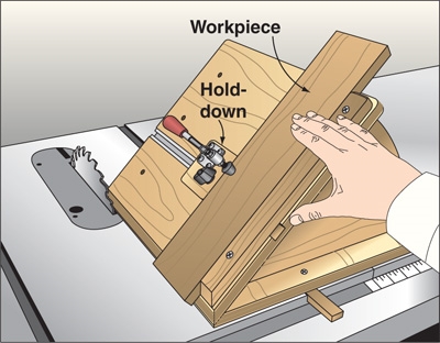

How about one of these........
[ATTACH]22345[/ATTACH]
- 45 degree bevel sled 1.jpg (73.98 KiB) Viewed 1450 times
