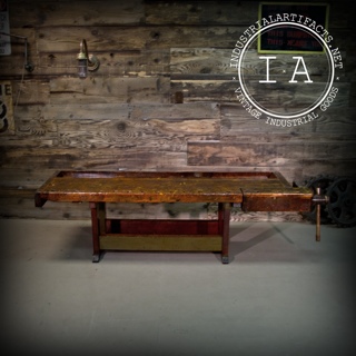

Heck no, Steve. You are clearly on the leading edge of the "urban vintage industrial chic style"! Look what I stumbled upon yesterday while looking for ideas to best use a pair of old cast-iron workbench legs that I got for free. (Actually, I got the whole workbench for free, but the lumber connecting the cool old cast-iron legs is worthless junk.)skou wrote:OK, the ER is stripped down, except for the bench.
Am I the odd one, thinking an antique ER bench makes a decent coffee table?
[ATTACH]22560[/ATTACH]
Here's a link to some more photos: http://www.industrialartifacts.net/coll ... ffee-table
Yup, that old workbench top is priced at $1200. Apparently, vintage industrial chic sells for big bucks to the Manhattan Yuppie crowd. Lord knows, even with their outrageous salaries, most still can't afford a parking spot for a car ... and so they don't have cars. But then competing for some pretty cool old rust-belt junk gives them something fun to do with all that surplus cash. Heck, if I had a spare $1200 burning a hole in my pocket, and the wife would tolerate it, I'd like to have that "coffee table" myself!
So I figure there's gotta be a goldmine in vintage 10ER bench furniture. Steve, you hereby officially get credit for being the first to spot the "killer App". Tap into the right market, and the bench is worth way more than the speed changer. So maybe we can finally balance supply and demand for good old Shopsmith machines!
Seriously, everyone, check out the stuff at the web site:
http://www.industrialartifacts.net. I'm torn between consternation at the outrageous prices paid for some pretty common junk, and appreciation for the eye of the beholder that found beauty in some old and beat-up, but very well-crafted old industrial artifacts. The story of the business is a thought-provoking read.
- coffee table.jpg (41.31 KiB) Viewed 1498 times

Unbelievable. My wife absolute LOVED that "coffee table"!BuckeyeDennis wrote: Heck, if I had a spare $1200 burning a hole in my pocket, and the wife would tolerate it, I'd like to have that "coffee table" myself!
I am now accepting donations, with a goal of raising $1200. Please give generously!
