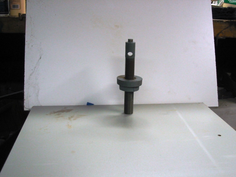

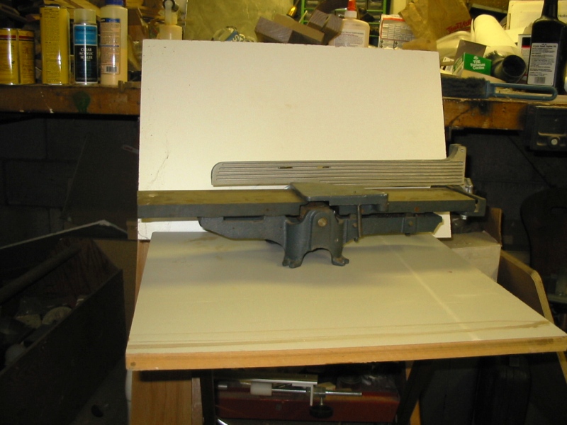

Bought a 10ER at a estate sale this weekend and these came with it. I know the first is a jointer, but is it a SS jointer? Year? The second I'm not sure what it is or if it goes with the 10ER, it's about 6 inch tall with threads most of the way. Any help would be greatly appreciated.

The first thingy is definitely a jointer, but definitely not a Shopsmith jointer.
The second thingy is, in my opinion, the upper portion of a floor jack -- the sort of jack you put under the joists of a sagging floor section in an older home to keep it from sagging further. I sincerely doubt that it was a Shopsmith Floor Jack -- unless the old Magna Engineering folks had a subdivision I don't know about.

Thanks Nick for the info, had a feeling the jointer was not a SS. and now that you mention it the screw thingy does look like part of a floor jack. Must have been mistakenly put in with the SS parts. A couple more questions, the serial# on the ER looks like ER20234 and when I looked it up it says it was made around "73". I thought ER's were older than that? Also the headstock seems to be "frozen" on the way tubes, any suggestions on freeing it up? Thanks!
