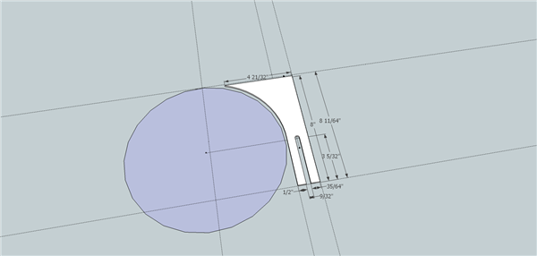

Cutting wet wood (especially ripping wet wood) will always have potential for serious problems. Using wedges may reduce the propensity for those problems but will never eliminate them. I suggest that "no wet home" is the only way to go.
Making your own slitter is really quit simple IF you can find suitable materials of the right thickness.
[ATTACH]22803[/ATTACH]
If you do make one, don't leave that sharp point on the end. Making unplanned contact leaves a nasty gash. Round it off!!!
BTW
The stock splitter is the same .075" thick. So the option of finding a used one then cutting to make a new version exists. Not sure you can save much money that way but it would be simpler.
