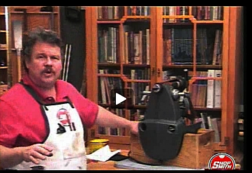

I KNOW I have seen a plan for a wooden cradle for the Shopsmith headstock but I cannot find it anywhere. Somebody please point me to it? I have a PowerPro on the way and want a secure storage cradle for my old unit.

I don't know of a plan, however as I remember there is one in use during one of the later "Sawdust Sessions". It is a simple box with the ends scooped out at the same curve as the motor pan of the headstock. To make one you can bremove your motor pan and use it as a template.
Since your motor is fastened to the pan, you'll probably not want to do this. It would be awkward and heavy.
A solid box with modified V shaped ends would do the job very well.

charlese wrote:I don't know of a plan, however as I remember there is one in use during one of the later "Sawdust Sessions". It is a simple box with the ends scooped out at the same curve as the motor pan of the headstock. To make one you can bremove your motor pan and use it as a template.
this is what I will do. I called SS customer service and there is no plan for the cradle, but they sent me a picture of one they use. Guess I remembered seeing it when viewing a Sawdust Session or something...thanks for coming back to me...

Would you please post the photo? I have an additional headstock I would like to safely store.

This may be what you seen.
Bruce
Ok Ok, I'm up to four now...
lightnin wrote:This may be what you seen.
A different view.
[ATTACH]23110[/ATTACH]
headstock cradle.jpg (83.73 KiB) Viewed 3440 times

That would be a great project if my headstock wasn't apart, I could one right now too.
