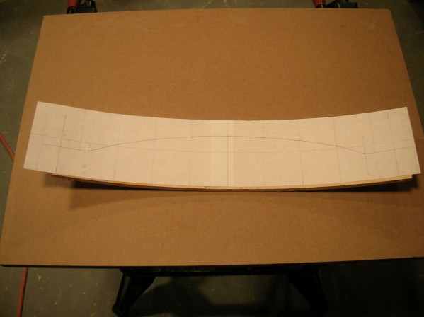

While the paddle project is off at the woodburners, I decided to take a break from the canoe build also and make a small camp chair. Its a good chance for me to try and improve my joinery skills, which are sorely lacking.

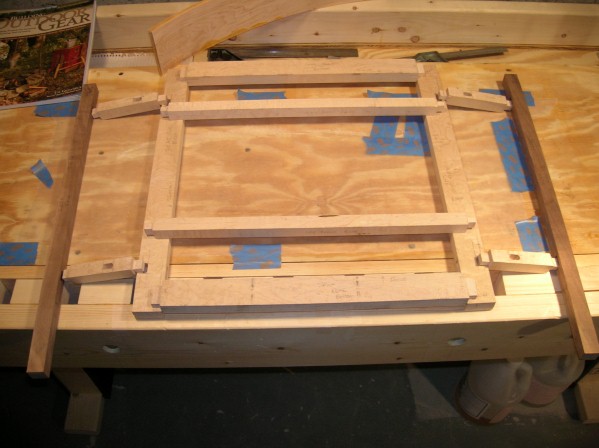

I started by planning down some 4/4 curly maple stock I had to 3/4", and cut sanded the various pieces to length and width. Tenons were then cut. Getting stock to final thickness is one skill I still need to improve on. It seems like most of the rough lumber I have is either twisted or cupped, and Im not sure that Im following the correct procedures, things seem ok but some of the pieces had ever so slight twists.

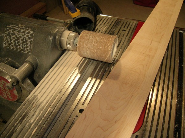

I cut three 1/8" x 3 1/2" pieces of veneer on the bandsaw. Resawing to me was always a daunting task until I bought a new blade, since then its worked flawlessly. I mounted a 2 1/2" sanding drum horizontal as shown in the photo to sand out the band saw marks and bring the pieces into final size, I had read about this in my manual but this is the first time I tried it, not as slick as some of the home made drum sanders Ive seen some of you do, but for this project, it worked very well.

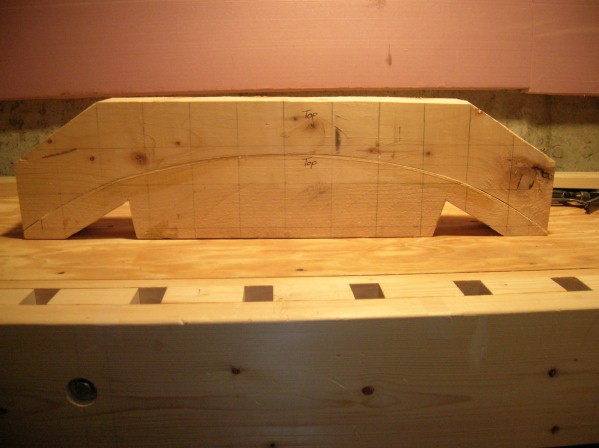

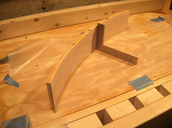

I then laminated three 2x4's and layed out a clamping form in a radius shape for the chair back, this was also cut on the band saw, the drum mounted in the drill press mode cleaned up the inside surface's perfectly. After lining with tape, I glued up the back and clamped up for a couple of days. Came out pretty well, square anyway, which for me is a major accoplishment. I layed out the chair back on paper and glued it to the lamination, and cut this out with the bandsaw. The sanding disk brought things right to the line. The trick for me was cutting the length of the tenon for the chair back, I finally layed out the inside dimension of the finished chair back on a work surface and set the curved section on top of this line then I used this reference to transfer marks to the wood with a square, cutting along this line with a straight back saw to make the tenon cheek i could then use a chisel and work my way down to the tenon thickness. Seemed to work out fine. One thing I really appreciate about the ShopSmith is the versatility. I angled the table in drill press mode and using a 5/16" router bit in plunge mode I cut an angled mortise for the seat back to rest in. Not having a "wixey" i used the Iphone angle gauge, I checked this with a couple different angle finders, thumbs up. All the sections were glued with epoxy thickend with maple flour, that will take care of any gaps in my joinery.

"The trick for me was cutting the length of the tenon for the chair back, I finally layed out the inside dimension of the finished chair back on a work surface and set the curved section on top of this line then I used this reference to transfer marks to the wood with a square, cutting along this line with a straight back saw to make the tenon cheek i could then use a chisel and work my way down to the tenon thickness."
You methods are tried and true - much better than using a ruler!

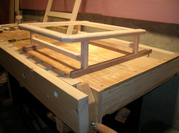

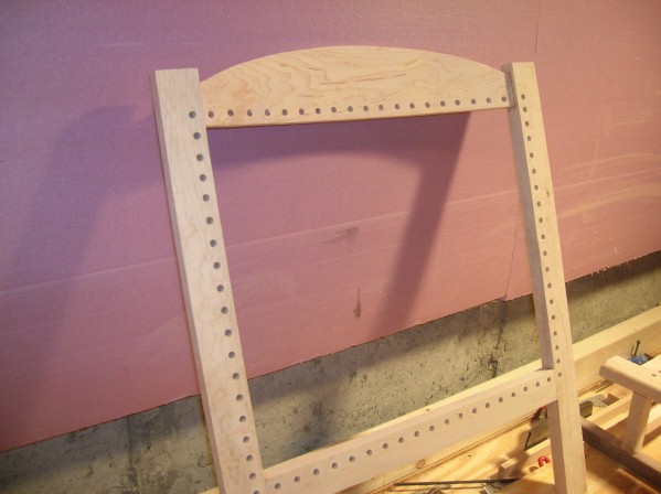

Some progress photos, holes drilled for caning. Also now have the legs, skids, and brace's glued up. Some rough sanding to do and then two coats of exterior poly before caning will begin.
