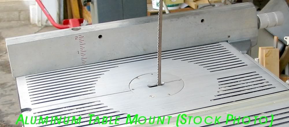

If the fence rail is removable, it is the same extrusion used for the bandsaw fence rail and also for the bandsaw table extension on the aluminum bandsaw fence. The 500 fence can be used with the bandsaw once the rail is mounted. (I have shortened the fence so it does not hang over the bandsaw table.) You will have to file a notch out to allow for the miter slot in the bandsaw table.bobgroh wrote:Should be 'upconverting' my son-in-law's 500 to a 510 at Christmas time and, as partial compensation, I am getting the 500 parts from the conversion (i.e. table, carriage, extension tables, saw guards, etc.

Can you post a picture
Very interested in what you stated can you post pictures of this bandsaw table conversion ?SDSSmith wrote:If the fence rail is removable, it is the same extrusion used for the bandsaw fence rail and also for the bandsaw table extension on the aluminum bandsaw fence. The 500 fence can be used with the bandsaw once the rail is mounted. (I have shortened the fence so it does not hang over the bandsaw table.) You will have to file a notch out to allow for the miter slot in the bandsaw table.
