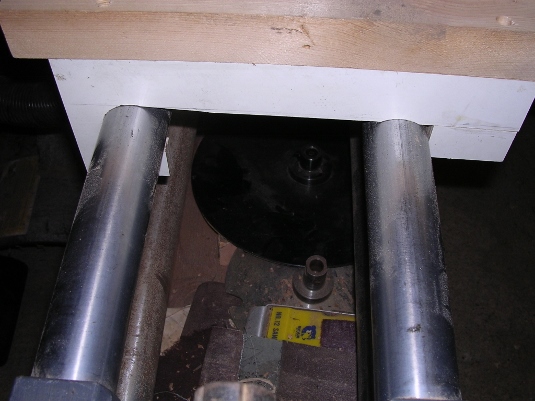

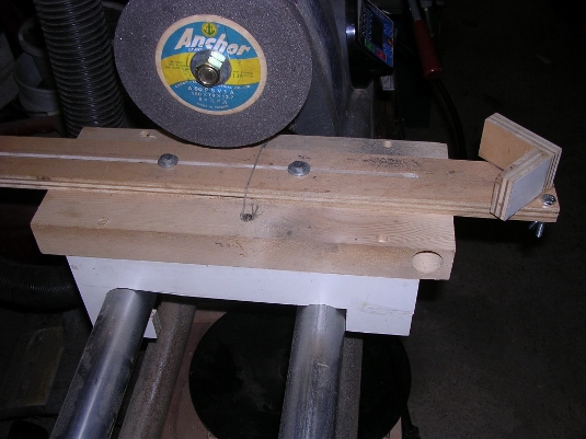

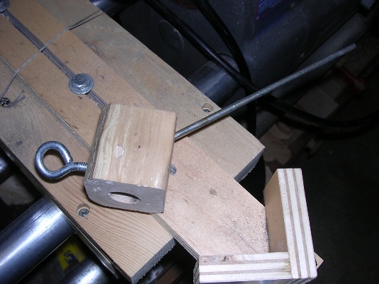

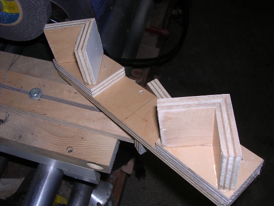

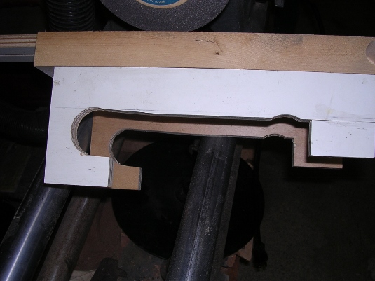

I had this issue of not knowing how I was going to sharpen my lath chisels, and wanting to be able to sharpen when turning, I came up with this idea. Having already had a bench grinder that died, I mounted one of the grinding wheels on a 1/2 inch bolt, cut off the head, then mounted that end of bolt in my 1/2 inch router chuck mounted on the left side upper drive shaft of shopsmith.
I then made an adjustable v that hooks over the rear way tubes and drops down over the front way tubes and locks in place. modeled after the wolverine grinding set up.
I won't be home for a couple days, but will try to take a couple pics and post.
Made entirely of scraps except the 1/2 inch bolt. It alloys me to sharpen as I'm turning without leaving the SS.

Here are some pics of my homemade sharpening system.
First time attaching pics so I hope I did it right.
- DSCN4073 (535x401).jpg (131.6 KiB) Viewed 2183 times
- DSCN4074 (535x401).jpg (113.32 KiB) Viewed 2178 times
- DSCN4075 (535x401).jpg (126.54 KiB) Viewed 2179 times
- DSCN4076 (535x401).jpg (142.25 KiB) Viewed 2174 times
- DSCN4077 (535x401).jpg (129.48 KiB) Viewed 2176 times
