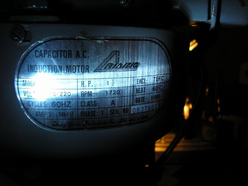

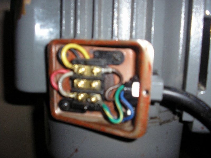

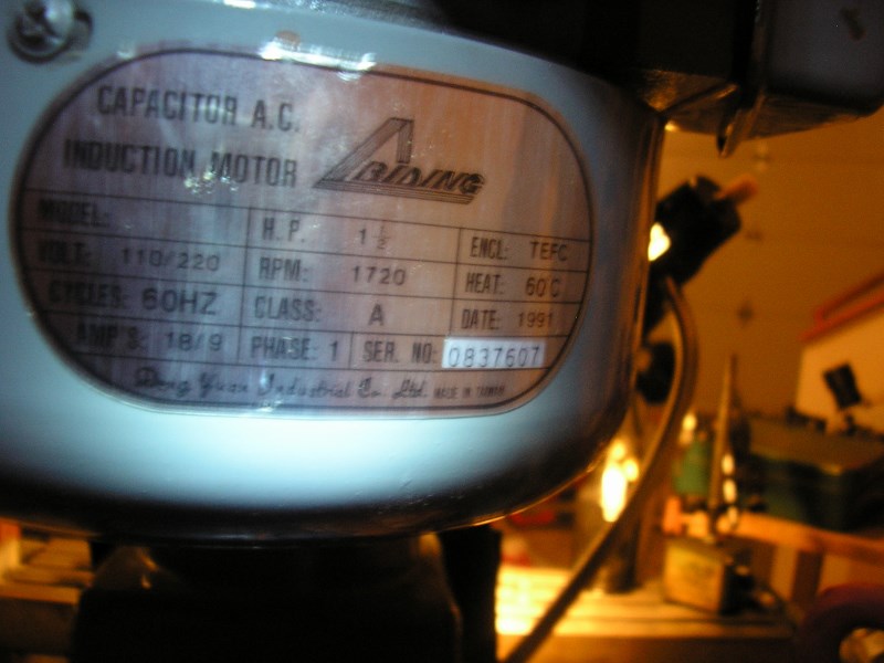

I bought a good size milling machine. Thing is, after many years and someone elses fiddling the wires to the switch have been replaced so old wiring docs don't measure up.
I took these pics. The motor is capable of 220 and is supposed to be reversible. I gather the 4 wires shown in the pic are the coil leads. So how would you guys suggest to fit in a reversing switch? Or, how to tell what wires to fit the switch to?

It's wired 110 now as you can see in the last pic. The wires to the right of the black, gray, yellow, red go to the switch.

Why is the blue neutral wire connected to the green/yellow-stripe ground wire? That should not be! The ground wire needs to be attached to the metal case of the motor. Right now, if something burned up in the motor and a live wire came to touch the metal case, it and probably the whole machine would be at 120V. Is there not a screw inside that wiring box to attach the ground wire to in order to connect it to the metal chasis?
Good catch. Let me get back out there and see and or rig it up that way. Totally went right by that.
Found the proper location for green after some messing around. I managed to wire up the electronics box in back as much had been disconnected. Just missed this up at the motor. So anyone have any thoughts on which 2 of the 4 (gray, black, red, yellow) need to be switched to run reverse?
Normally, any 110//220 VAC reversible motor has 6 wire leads going into the motor. Four for the run windings and two for the start windings. Get an ohm meter and check the resistance between each of the two wires. The run windings should be around 1 to 3 ohms and the start windings from 4 to 7 ohms. You should not get this low resistance between all combinations of wires, only 2 sets of wires. Also check that no wire is shorted to ground. You only have to switch the start winding wires for reverse operation. Let us know what the ohm readings were for each pair of wires along with their color. Again, normally red and black are the start windings if the motor wires are color coded to the US standard.holsgo wrote:Good catch. Let me get back out there and see and or rig it up that way. Totally went right by that.

'Supposed' to be reversible.
Says who?
The plate does not.
I think the wires are the run windings. The "+" symbols on the plate indicate wires 'connected'.
i.e. 115v.................230v

Q1 Are the wires totally free from any external connections when making the 'test'? That means all four are flapping in the breeze.holsgo wrote:Here's the test
Black yellow is 1.3
Red gray is 0
Red yellow is 0
Red black is 14 when first touch and drops to .8.
