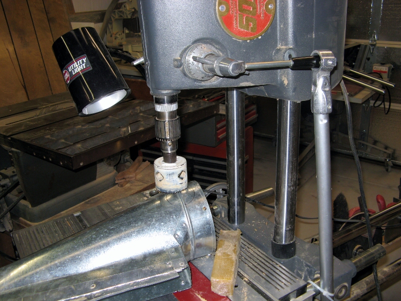

Edit: (See Post #10 for parts list and a simpler version using the complete extension table at the top.) I needed to make a double sided name sign for the mail box post. Not exactly top of line Shopsmith but it will work for what I need to do. While some the items I used were things I had on hand I will include a like item from Lowes.com. Actual cost if you buy everything except the extension table should be $40 or less.

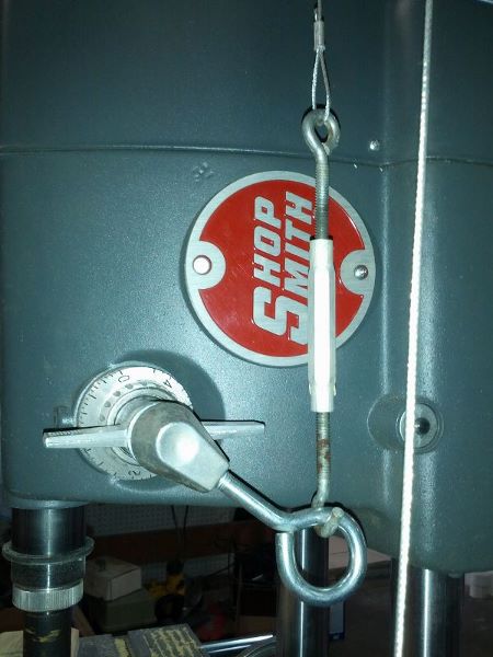

I ground the end of the eyebolt in this picture as near as possible to the shape of the quill handle. Eye Bolt 3/8"x 4" #22216, Cable 1/16" Weldless Steel (by the foot) #348161 buy ten feet, Turnbuckle 5/16"x 9" #22241, Chain Ferrules and Stop 1/16" #348525, a Chain Rope Clip 1/8" #348300 (buy 3 each total) as in picture 3 can be substituted for the Ferrule.

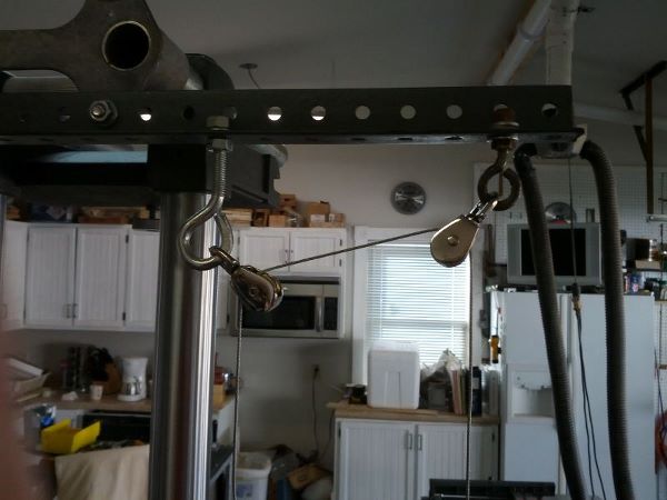

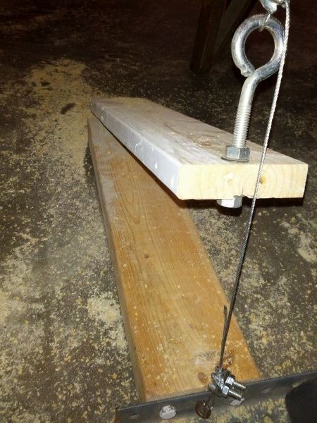

I used an Extra Extension Table leg set with an angle iron bolted to it (similar to Plated Steel Slotted Angle 3' x 1 1/2" #69814). Don't make me look up bolts. Get three of the smaller eye bolt. Eye Bolt 1/4" x 2" #22065 (third one for the foot pedal below) to use with the 1/8" Chain Swivel Pulley #348546 2 each. The eye on the eye bolt has to be opened up and attached to the pulley eye and then hammered or squeezed back together.
Note: An alternate method would be with a complete extension table and clamp the slotted angle to it with a Top Beam Clamp 1/4" x 20" #47469 3 each and screw the eye bolts into two of the beam clamps. Edit: Leave out the slotted angle and use 2 each Top Beam CLamp

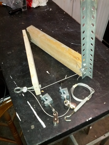

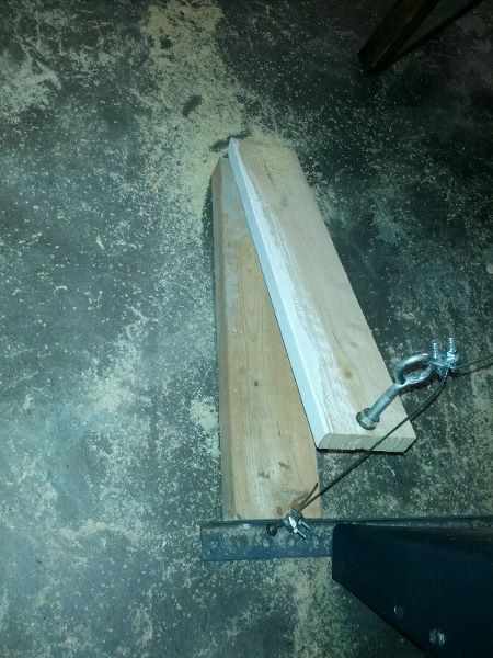

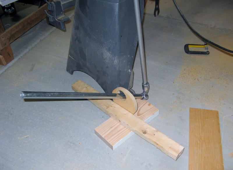

For the foot pedal I used a 2x4 16 inches long, a 1x4 16 inches long, a 2 1/2 inch Entry Door Hinge #308971, the cable is continuous from the quill handle eye bolt to the Plain Eye Bolt 1/6"-14x1 5/8"in the 2x4 (the one I had on hand was only 1 3/16" long with a 3/8" eyelet). The slotted angle is attached to the 2x4 with two Lag screws but large screws would also work. The Shopsmith leg sets on the slotted angle keeping the foot pedal in place.

The cable from the foot pedal eye bolt to the 2x4 eyebolt has to be adjusted for the amount of quill handle travel. Actual quill travel is about an 1 1/8".

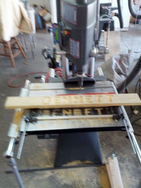

I used a table insert with a 3/8" overhead router pin to follow an old Craftsman letter template. I also used a 3/8" carbide straight router bit in the Shopsmith router arbor. PTWFE in figures 22-36 & 22-37 shows how to aline the pins. http://www.shopsmith.com/academy/routing2/index.htm#duplicating
[ATTACH]23937[/ATTACH]
The sign is lettered on both sides and I will shorten and rout the edges. I tried a V-groove bit also but the letters in the template were to wide.

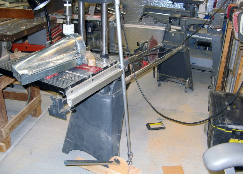

The pictures show my solution for the need of a third hand. I used the extension table poles and flexible joints.

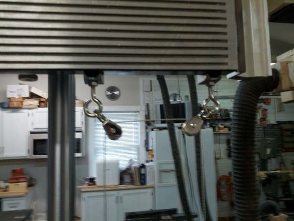

Here's the top using a complete 520 extension table and the Top Beam Clamps.
