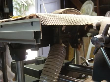

Yet another function I discovered my SS can perform!
I replaced the throat plate with the dust extractor fixture for the drum sander and cut a piece of Contact brand non-slip shelf covering to fit the table. (It is the basically the same stuff as the router mats, but about a tenth of the price.) Connect the dust extractor and volia! a nice way to control the dust when hand-sanding plus it gives you a flat surface that won't mar your piece.

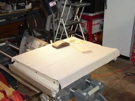

I just tried this today and found it worked quite well considering the small hole that is causing the downdraft. Besides picking up dust as you sand, running the piece (if it small enough) over the hole cleans off the piece quite nicely. If I had one suggestion it would be to support the main table with the fixed extension table and tubes connecting them to reduce pressure on the main table. I didn't do this but will the next time as I tend to apply a lot of pressure to my sanding block.
If nothing else, this trial really showed the benefit of a downdraft system to reduce sawdust as you sand.
