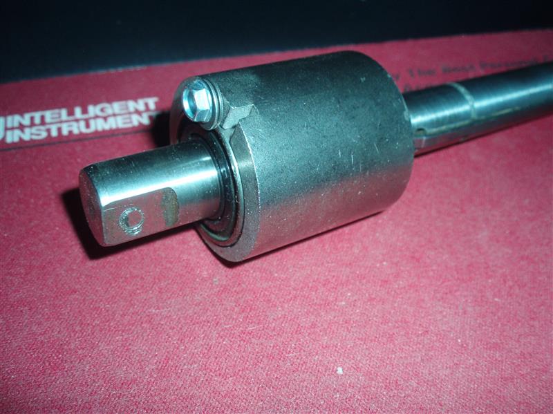

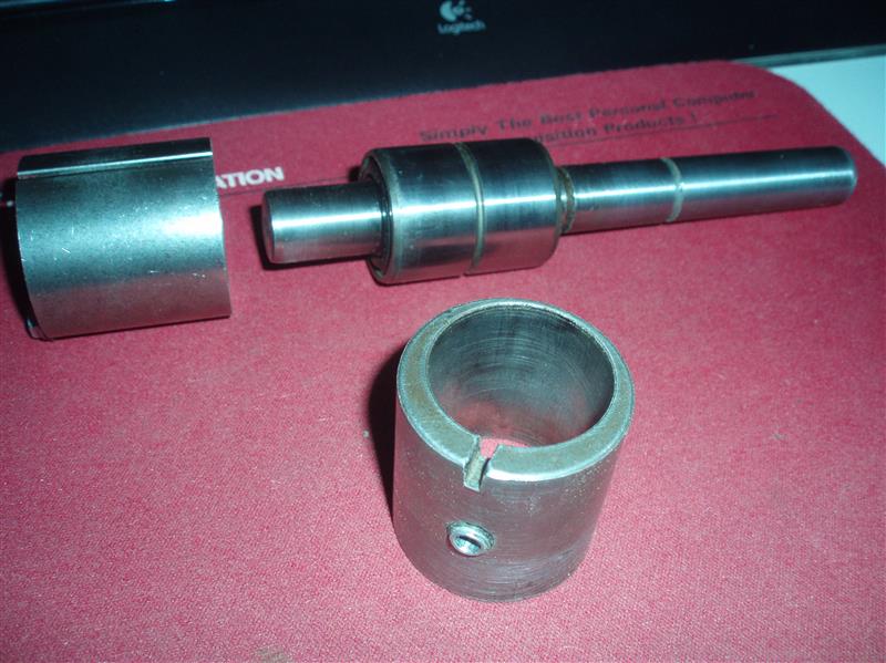

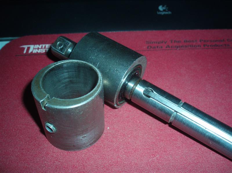

I just stripped out the keyway in my control sheave. I found a complete assembly on ebay but it appears to be the old style shaft with a single long bearing on the drive end. My 510 has the newer shaft with two narrow bearings.
The SS parts site says that a new shaft will require the new eccentric bushing.
My question is does the old shaft (bearing) fit in the newer eccentric bushing?
If not I'll likely keep the shaft I have and just sub in the sheaves, or maybe the sheaves and bearings if that's do-able.
shipwright wrote:I just stripped out the keyway in my control sheave. I found a complete assembly on ebay but it appears to be the old style shaft with a single long bearing on the drive end. My 510 has the newer shaft with two narrow bearings.
Yes, it fits and I see no reason why it would not work.
I bought the new shaft and I believe I retained the old shaft and eccentric. I'll double check.

[ATTACH]24173[/ATTACH]
[ATTACH]24174[/ATTACH]
[ATTACH]24175[/ATTACH]

- New Eccentric 001 (Custom).JPG (76.98 KiB) Viewed 4366 times
- New Eccentric 002 (Custom).JPG (75.85 KiB) Viewed 4365 times
- New Eccentric 003 (Custom).JPG (73.47 KiB) Viewed 4365 times

Thanks Dusty. My guess is that SS says you need to change to the newer split type for the new two bearing shaft because the old set screw would hit between the new bearings and not retain anything. The single long bearing should have no problem however being squeezed by the split bushing.

Keep yer new shaft, bearings, eccentric, and idler sheave retaining clip. Use the key, idler sheave and control sheave from e-bay.(see below)
The 2 bearing setup is better than the older setup. Now would be a good time to replace those bearings if they are close to needing that.
The new eccentric will work with the older bearing, as it is split and will squeeze the bearing as the clamping screw is tightened.(the easier way;))

I find the most important thing is to use a 3/4" body washer to retain the idler shaft bearing and eccentric bushing inside the headstock. The stock washer is too small once the eccentric bushing is more than half way twisted for the belt tension to prevent the idler shaft bearing from coming out of the eccentric bushing. The split eccentric bushing will work with any idler shaft bearing setup. I am finding eccentric bushings without any set screw or retaining screw in the eccentric bushing end where the idler shaft bearing had not spun in the eccentric bushing but remained fully seated. The large body washer works well for this eccentric bushing. I believe the belt tension is what keeps the idler shaft bearing from spinning in the solid eccentric bushing without a set screw. So far, I have 5 different eccentric bushings that Shopsmith has used in the Mark V headstock.

The reason I consider it 'better' is that the dual bearings are replaceable, whereas the older water pump bearing is not. That said, the older bearings last a very long time if not squeezed too much.shipwright wrote:Thanks JPG, that's what I was leaning toward anyway. If the new setup is better, then that clinches it. The bearings are fine.
