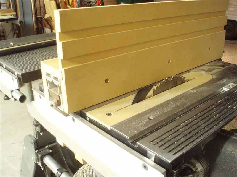

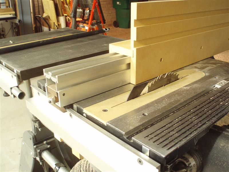

I read a post the other day (on another forum) where the author was advocating a shorter rip fence claiming that it was safer to use. His opinion seems to be based on a belief that most kickbacks are caused during ripping when the work piece clears the back edge of the blade. At this point in time the work piece is pinched between the blade and a full length rip fence with nothing securing it. Thus a candidate for kickback. Relieve the pinch and "no kick back".
His solution is to use a short rip fence; one that ends at the same point where the work piece clears the back of the blade.
I would be interested in hearing everyone's' opinion on this.
[ATTACH]24181[/ATTACH]
Long Rip Fence
[ATTACH]24182[/ATTACH]
Short Rip Fence (produces no pinch thus no kick back)
Long Rip Fence
- Short Rip Fence 005 (Custom).JPG (72.04 KiB) Viewed 3091 times
- Short Rip Fence 007 (Custom).JPG (79.26 KiB) Viewed 3092 times
