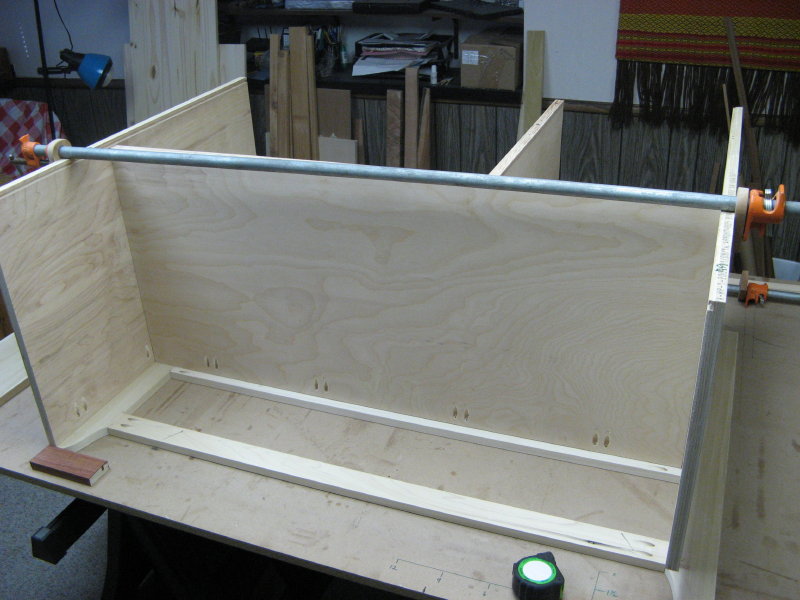

I'm building a bathroom vanity. Everything is cut and I've dry fit the pieces and this is the point I always ask this question - should I
assemble the unit and then stain/finish or should I stain/finish and then glue and screw it together.
[ATTACH]24621[/ATTACH]

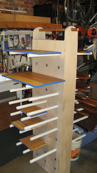

I find it a lot easier to put apply sealer, stain and a top coats to small straight pieces rather than a large face frame unit. I have a
nice drying rack that works great for rails and stiles. BUT there is all that taping to do first.
So what's your preferred method and why?

I was taught to shellac wash first (3 parts shellac 7 parts denatured alcohol) then stain, then two coats of poly urethane. I used oil base Armor Seal satin finish. Let dry, then VERY lightly sand with 320. Blow off dust instead of cheesecloth. Then assemble. When assembled look for any dings that may need touch up, address them, then apply the last coat of urethane. Also use a foam brush for the urethane going with the grain, and apply in in direction. Doing so lessons the bubbles in the finish. The reasons why, is so the project will be built mostly finished, any flaws addressed, lastly only the finish coat is the last step
I like to finish each piece as it gets ready to assemble whenever possible. I use only urethane to finish my projects. I'm not pleased with any other finish. Urethane likes to run if you get it too thick, so finishing each piece when you can lay it horizontally eliminates runs.
Premium wood species don't need any stain, and I feel that if I'm going to build something, why not use a premium species. This way, I can also eliminate the step of staining.
Some projects just don't work well to finish individual pieces, so sometimes I end up finishing them after assembly even though it isn't my preferred way.
My only advice is to do whatever works best for you.

The complexity usually determines it for me. These racks for hanging glasses just had too many glue joints to tape reliably before finishing. I taped them to minimize glue squeeze out and will finish them later.
