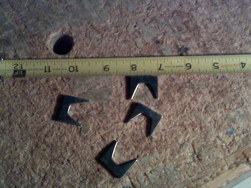

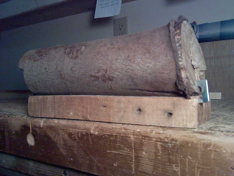

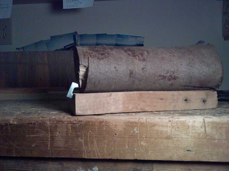

Here is another way to get the log fixed to the guide board, using mini pinch dogs. Think I found them in the Veritas catalog a while back. The "log" in the picture is a piece of eucalyptus my bil gave me last month. the plan is to mill some 1/4 inch boards and make a little box.

edflorence wrote:Here is another way to get the log fixed to the guide board, using mini pinch dogs. Think I found them in the Veritas catalog a while back. The "log" in the picture is a piece of eucalyptus my bil gave me last month. the plan is to mill some 1/4 inch boards and make a little box.
Thank you, thank you. I've got some of those and never knew what they were. I don't even know how or when I came to possess them. I still have them because I discard very little.
Ed in Tampa
Posts: 5834
Post by Ed in Tampa »
They look handy. Found them at Lee Valley. Woodcraft has 10 of them for the same price Lee Valley has an 18 piece set for.
