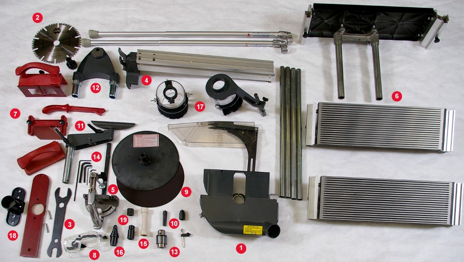

I think at the simplest level you could fabricate this by attaching a hose to the shaper fence
[ATTACH]26583[/ATTACH]
With my M7 I received two router shaper shields, one mounts on the quill however the other has a stem that mounts on the table using the sliding t nuts (#17 right side). That second one might be acceptable for your use if you can find one. I briefly looked on the SS site but could not find a listing or part number. If you check out a picture of the standard accessories you can see both shields.
[ATTACH]26584[/ATTACH]

Thanks for the idea Ben. I do have one of the (#17 right). I'll have to look at doctoring something and fabricating some sort of holder. It looks like that may work. Thanks for the idea.
