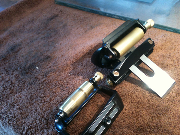

What is nice is that you have a choice of a purely straight edge using the flat included roller or you can camber the edge by using the barrel roller. In this picture I have the blade holder on the flat roller:

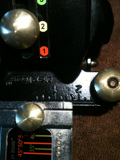

The blade setting device has pin-holes for various angles and the colors are used with the color that the blade holder is set to. In the above picture I am honing a 45 degree angle so the blade holder is set to the red dot and the blade setting device is set to 45 degrees on the red scale. This hone was for a cabinet scraper blade.

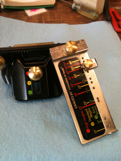

The blade setting device has a marker on it that should be lined up with the blade width markings on the blade holder. Here I am honing a block plane blade of 1 ⅜ inches wide. Doing this sets the blade smack in the middle of the blade holder so you can easily apply even pressure when honing.

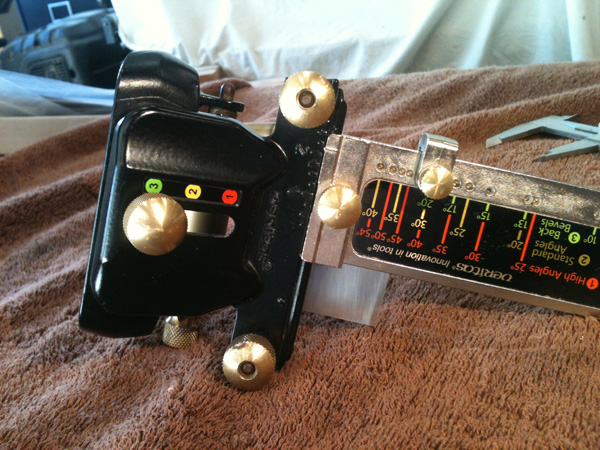

The blade is installed in the blade holder and its projection is set by the indicator on the blade setting device:
[ATTACH]27028[/ATTACH]
That is a phony setup since I don't hone back bevels and the blade is the wrong side up for a back bevel. Photographic license.

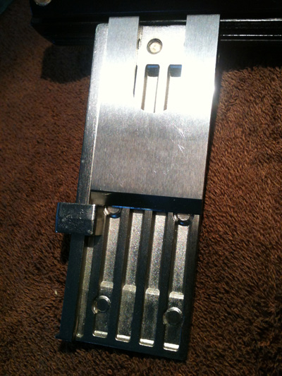

The last picture shows the back side of the blade setting device with the blade edge touching the indicator and parallel to the side of it. This assures that the edge ail be perpendicular to the blade side - assuming you have followed the directions.
