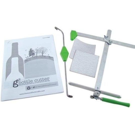

Hello, I saw your post and just wanted to respond with my bottle cutting experiences. The best bottle cutter I have ever used is actually very simple. I have attached a picture, I've worked with stained glass as long as I've been woodworking and have cut many bottles with this tool. It's not always foolproof due to the irregularities in the glass. Now, on the Shopsmith, I suppose if someone made a diamond blade for the band saw and if you could rig some type water drip where the blade contacts the glass, with a low speed, this may work. I've also cut glass and tile with a diamond blade on my grinder and I suppose a diamond blade in the table saw might work but this can be very dangerous.

Just watched videos on the g2 glad cutter mentioned above. That looks like the best solution. It is a normal wheeled glass cutter (but with 6 wheels to rotate through as they dull) on a frame that makes sure the scored line lines up right. I wish I'd known about it.

Picked one of these very items up. I think I need my water much hotter than I had it, and wine bottles seems to be quite sturdy. The score isn't running yet. Will try water much closer to boiling next...hopefully that takes care of things.
