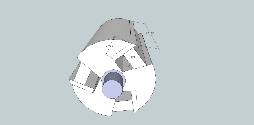

Does anybody know the size of the ShopSmith jointer blades? I called a couple of blade places and they keep on asking me the same annoying question: "What size are the blades?' I've never had them out or had occasion to measure them. Why not buy ShopSmith blades? you ask. At $50 they are 2X the price of other HSS blades available, and just about as costly as carbide tipped blades.

Re: Jointer Blades
You Betcha!!!!gr8mesquite wrote:Bob, I respect your opinion, and had the same thought, but..the internet and YouTube are full of articles and videos about sharpening jointer and planer blades.Are they all wrong?beeg wrote:I wood knot take them to be sharpened, because they will grind off to much steel.
One further question--"Are the SS blades so unique in any way as to be irreplaceable with after market blades?"
Thanks again
They are tapered which can cause problems for 'sharpeners'.
I Made a holder from a piece of oak an some walnut scraps.
If I can find the thread(a test of current search function), I will post a link.
Re: Jointer Blades
I'll try to answer that with a Sketchup of the cutter head.gr8mesquite wrote:Bob, I respect your opinion, and had the same thought, but..the internet and YouTube are full of articles and videos about sharpening jointer and planer blades.Are they all wrong?beeg wrote:I wood knot take them to be sharpened, because they will grind off to much steel.
Thanks again
- A Cutter Head with blade and wedge (Small).png (42.92 KiB) Viewed 10658 times

Your sketch attachment didn't come thru. Any idea of the thickness?
The point may be moot since JPG says the blades are unique.
