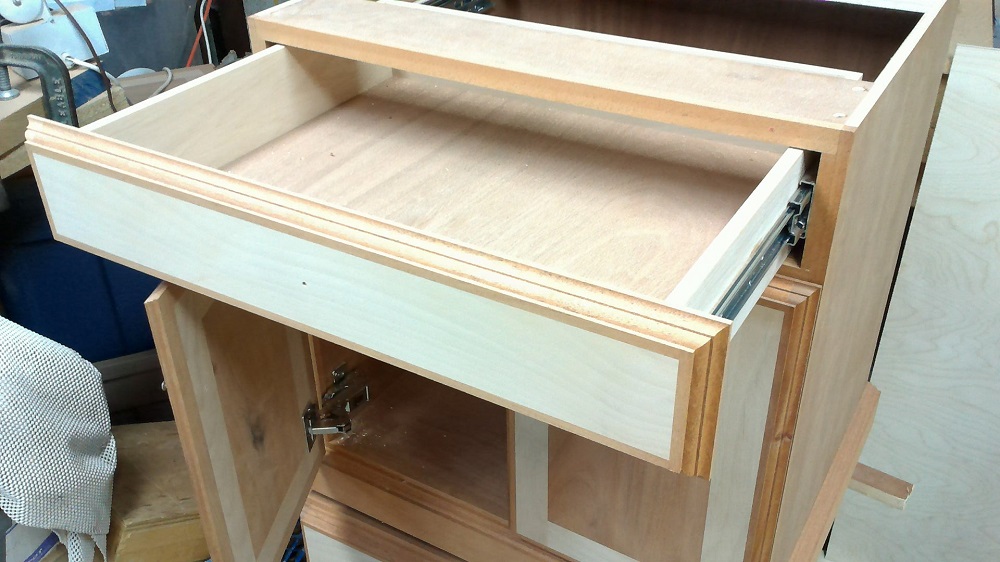

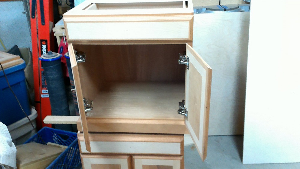

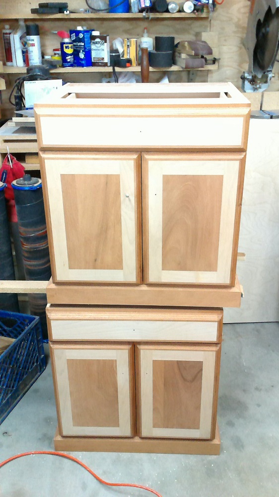

No nothing logistical. I have the onyx available. I think I may have solved the led issue. Several possibilities on them and yes all options seem to be expensive. Roughly $250 per panel. Oh well. I got the carcasses made yesterday so now I will tackle the stone and led issue. The onyx is readily available here in S Cal and they appear to be able to cut it within acceptable tolerances. The led panels will have to be ordered or possibly make my own if the lag time is too great.

Really nice cabinets, even with onyx tops. Just plain nice woodworking.
I just know you have a bunch of photos taken of the 'work in progress' that we would enjoy.

Thanks for the compliment on the cabinetry Dusty. I don't usually take pictures during the fabrication time but I can start ! I get caught up in the process and as they say time goes by. I have been making that style door and drawer fronts for years. Each door requires four different glue ups before they can be surfaced. But they are actually quite easy to make and the first few sets back in the seventies were made entirely on a SS. It was all I had. You can vary the contrasting woods for different looks. Those are Honduran mahogany and alder which is my wife's favorite combo. Another great combo is maple and Peruvian walnut.

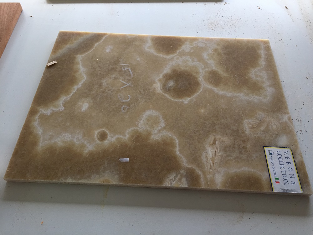

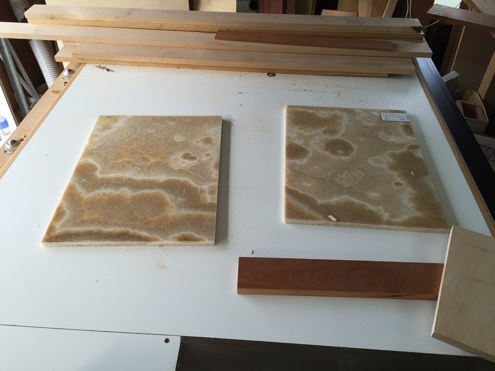

Well the boss finally found the onyx she wanted so now I can finish up the bedside tables and get them out of the shop. Next challenge will be the light panels for the onyx. I decided to make the panels out of 1\4" melamine and use the lighting strips with the self adhering backing on them. My only fear is the adhesive will give way somewhere down the line. Will have to wait and see. They sell led light bars that you could screw down to the melamine but they are quite a bit more money.
