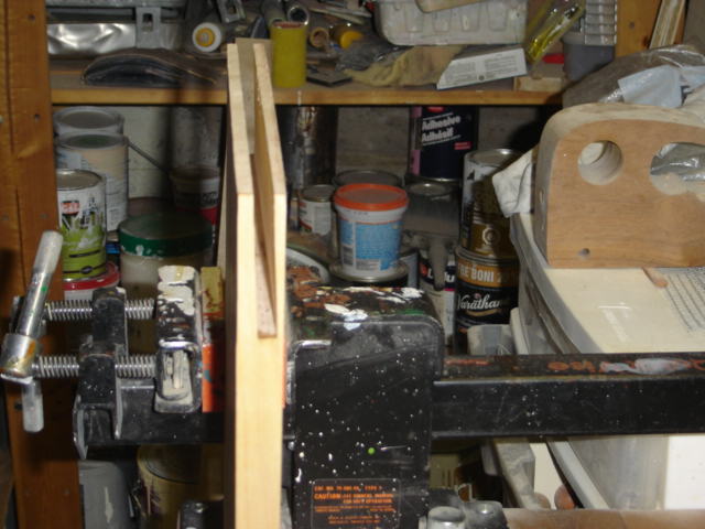

Then I really messed up. The next step was to cut dados in the ends of the boards to receive an alternate wood for handles and appearance. I had made a jig to make this easier but part way through my first cut, realized that in my haste, I had forgotten to use a zero clearance throat plate. It became obvious that if I continued, my wood would catch as it reached the end of the dado plate opening and all hell would break loose. Because I was using my left hand to guide the piece through, I didn't think I could safely shut off the SS so using both hands, guided the piece through without incident. Needless to say the dado was not as it should be, as can be seen in the attached photo.:o

I can't help with your weather or the planer. The sled should have worked to eliminate snipe. I suppose you had the sides extending about 5 or 6" past the rear of your board. Just don't know how the snipe happened. However, I agree that sanding sounds like your best bet from here, if you want to save the piece.
In another thread you said we would see a surprise in this week's blog. Well, I sure did! We both are glad that you did not receive any injuries. As I was reading, that horrible thought came into my mind.
I think I can help a bit with your end "dado". What I'd do is to saw off the narrower side and trim up the thicker side (looks like the left side in your photo). I'd use a vertical jig - like a tenoning jig (used with a table saw) - clamp your piece firmly to the jig and straighten the inside of the "dado" with the saw blade. From there, you can make a piece (like a heavy half lap joint) to make your 'handle edge'.
You said you used a dado blade to saw that deep groove. Wow! - looks like it is over three inches deep! I didn't know dado blade went that deep! Can't help but think a saw blade with multiple passes using a tenoning jig might have worked better. You could use a chisel to smoothe the bottom of the groove. A cut like that should be clamped to the jig - no hand pressure required, except on the jig! Are you working from a plan? How did they make that cut?

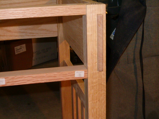

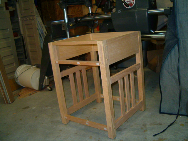

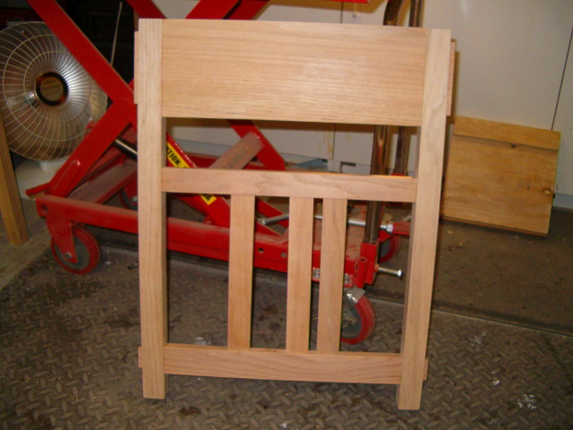

Well my week went a bit better. made progress on my daughter's end tables. Both table bases (frames) are now sanded and glued up. Now on to the tops, the drawers and the shelves. Here is a photo of one glued up base, a side of the other (before gluing) and a look at a thru tenon. The white spots are stickers, used to identify pieces and their locations for assembly. This is the first time I tried thru tenons. When I reached the 16th I was finally getting the fitting process figured out.
table base.jpg (125.07 KiB) Viewed 9972 times
table side during dry fit.jpg (126.2 KiB) Viewed 9975 times
Thru tenon.jpg (82.6 KiB) Viewed 9977 times

I too, was thinking that a tenon jig would improve a dado cut like yours.

The dado is 2" deep and yes I was following a plan. It called for a jig which I made but not clamped as a tenon jig would be. Maybe I should go back and check it out. The depth did challenge the SS but it ate through with a slow feed. Next time, if there is one, I will take shallower cuts. That's a good idea for the handles. I was considering changing the design and this would save the size of that piece.
