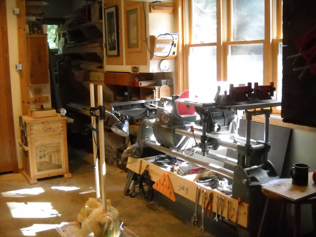

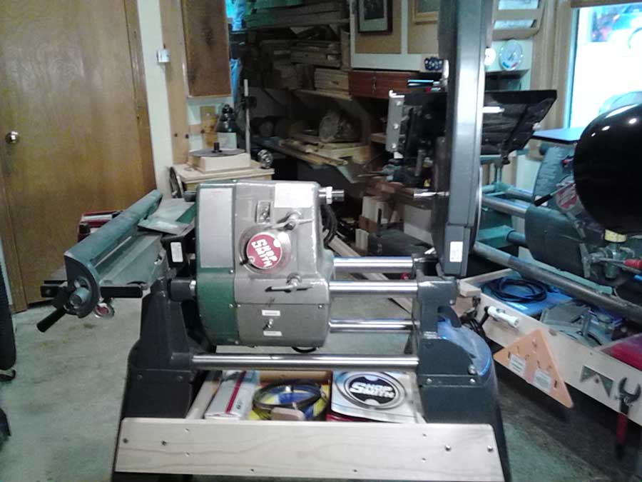

Hi John;
Just thought I would throw another idea into the mix - instead of cabinets under the Shopsmith, I opted to hang a tray from the legs. My reason for doing this was that I find I move the Shopsmith frequently and I did not want either heavy cabinets hanging from the tubes or cabinets I would have to deal with when moving the Shopsmith to and from its parking spot against one wall of the shop. My shop space is small (11 x 20) and am always turning the machine one way or the other to get the best light or to make room for ripping long pieces or to get from under the dust collector so I can set it up in drill press mode, and so on. But, I still wanted a way to keep featherboards, allen wrenches, extension cords, push sticks etc etc all close to hand. The attached photos show how I bolted a tray to the legs...this proved to be a good solution as it is light, convenient, holds a lot of stuff and does not hinder moving the machine. A fringe benefit that I did not discover until the tray was installed is that when using the table saw mode, the tray catches almost 100% of the saw dust that the dust collector misses. It is quick and easy to vacuum the dust out of the tray and really cuts down on the amount of floor sweeping. I liked the first tray so well I have also installed a smaller version on my new Mini.

edflorence wrote:Hi John;
What an outstanding idea! Looks great!

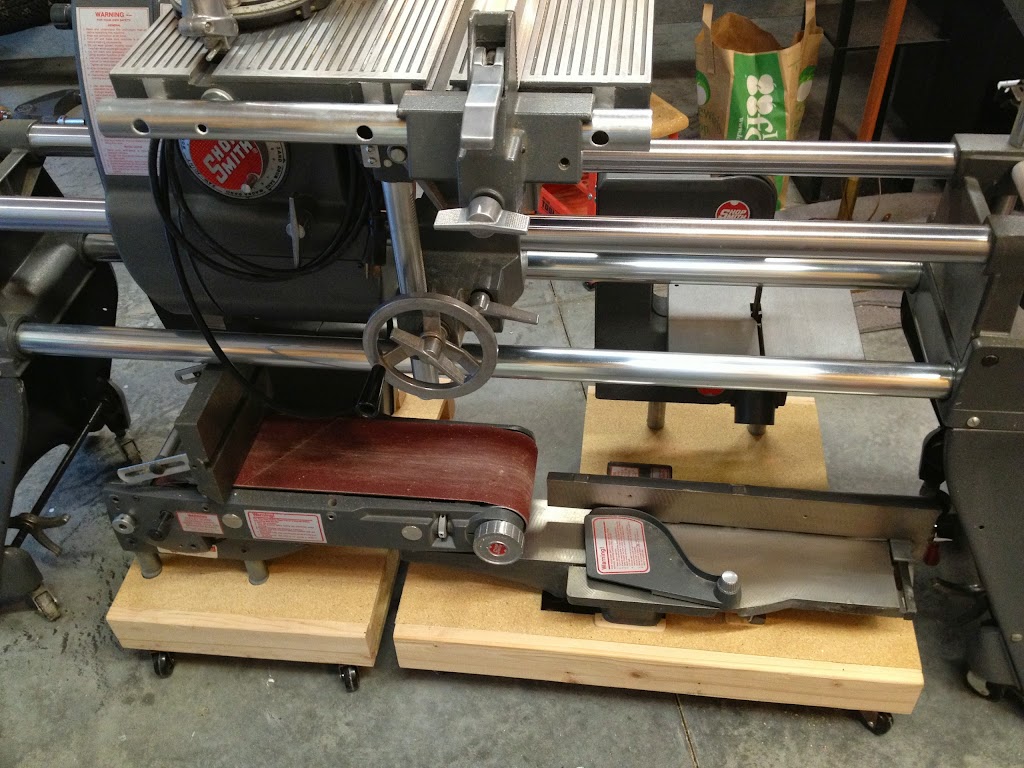

How do you keep sawdust out of the fixed trays? I like mobile separates for that reason.
edflorence
Posts: 689
Location: Idaho Panhandle
Re: Cabinet base for the Mk5
Post by edflorence »
I like those trays on wheels...clever idea. I have a clamp rack on wheels, and one of these days I would like to have all my lathe tools on a wheeled "tool tower"...one of these days. As far as keeping dust out of the fixed trays, I don't. I like the way they catch the dust before it hits the floor. Easy to vacuum the trays with the dc.
