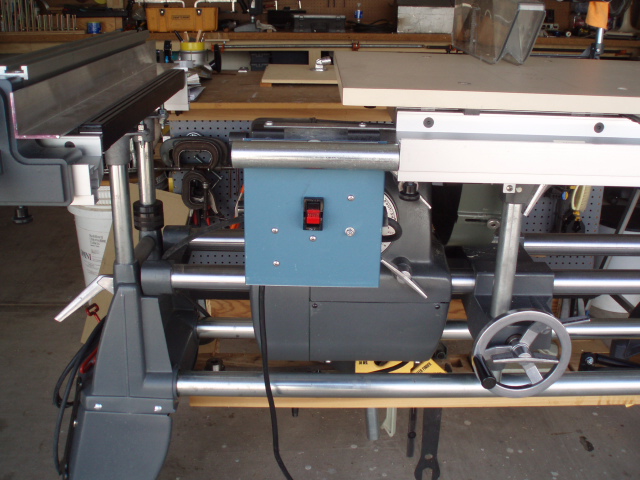

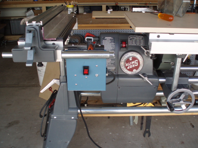

In another thread, two or three of you have reiterated the need for a safety switch (slap switch). I agree that there are some setups in which the on/off switch is not in the most convenient location. I have often thought about installing some sort of shut off that would be more readily available in an emergency. but never did anything about it.
But when I read the discussions today, I decided that I had to correct this situation for myself NOW.
The immediate solution does not employ a slap switch. I have simply relocated the on/off switch to the edge of the table. I have reinitiated a search for the right switch to use.

I have now. This is a temporary solution but will remain n place until I complete a new switch panel with a slap switch.
- P4010001.JPG (146.43 KiB) Viewed 10606 times
- P4010002.JPG (145.65 KiB) Viewed 10580 times

Jim, those are good ideas. They are especially good because you have implemented them. You'll never know how many incidents you may have avoided just because they were there.
Do you use the portable switch stand as your primary on/off switch or is this more an emergency shut down?
Thanks for the rare earth magnet idea. These could be used to attach to the way or bench tubes at any location or to the flat sides of the Shopsmith legs (front or back).
I negative thought comes to mind though. An emergency switch is something that you need to be able to reach for instictively. I believe it should be in the same place all the time. There is no time to ask "Now where did I hang that switch panel today"? Moving it around on the way tubes or like I do now may not be good ideas.
You will note that I like this switch well enough to also put it on my Combination OPR. A portable switch always has that risk that on a hurried day, it is not moved to the necessary location. Just my opinion. I do recall that my original posting of this option for safety was well received.mt1983 Mark V- beltsander, jigsaw, Stripsander,jointer, bandsaw-double carriage and tables with molders and drums, Over Arm Pin Routers(Freestanding x 2)Second Mark V.
Dusty, I use the kill switch only for emergency shutdown.
And I'm habituated to having the kill switch next to my right knee, which is where I always position it when working.
I certainly understand your and mtobey's point about having the switch always in the same location. For me, that's relative to my body, as opposed to a specific position on the machine, and I'm very careful about making damn sure it's always there. But you should do what works best for you personally. I have a large shop, with a number of stationary tools and, other than as my primary lathe, I use the SS as my multipurpose machine. I'm constantly reconfiguring it for horizonal and vertical boring operations - sometimes a dozen times or more a day - and as such I wanted the kill switch relative to me, not to the machine. But again, you should implement a solution that works for you and your work habits. Like you said, the important thing is to do it. Among many other duties, I was a Navy Safety Officer - so I tend to think safety first, and everything else second, plus I like having all ten fingers.
