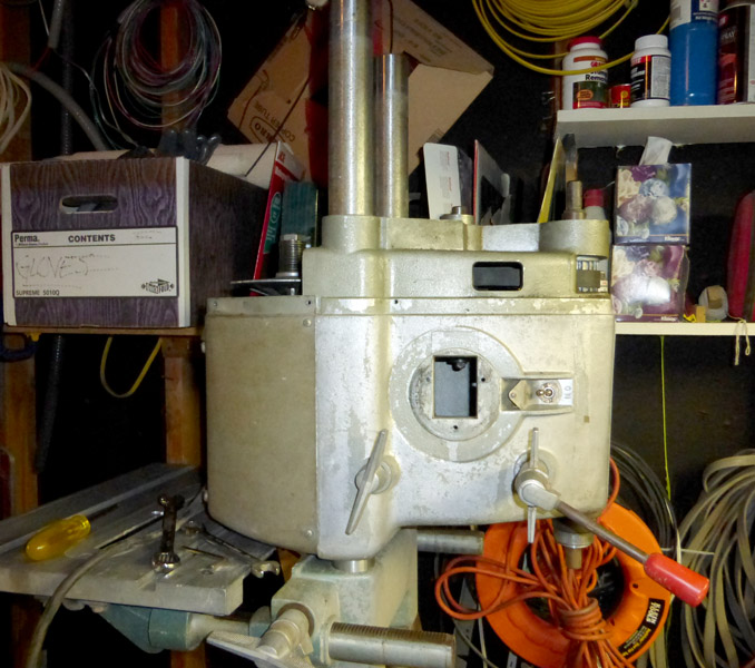

Hi JPG, I can't thank you enough for your generous help with my Mark 5. I actually removed the speed control earlier today and as suspected, the whole lot needs replacing. Like you said, there's not much of an opening on this model but it does help a lot.

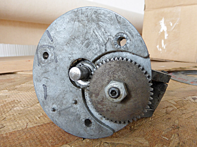

Hi Guys,
Thought it was about time to show the project ahead.
Here's the M5 as it stands this morning.

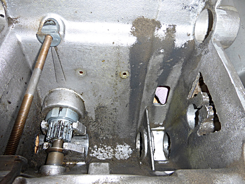

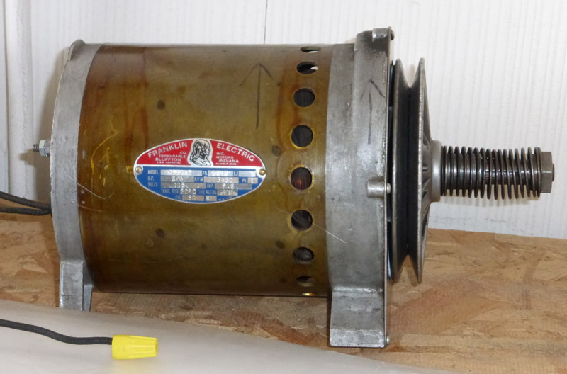

This shot shows the floating sheave spring and retaining nut. I'll need some help on the best way to remove this version.

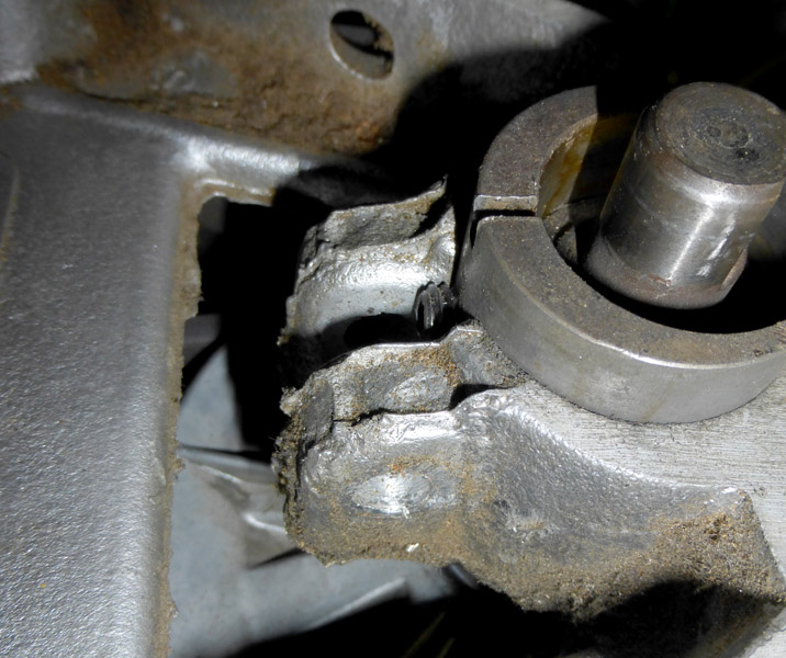

Here you can see a closer look at the old repair of the drive sleeve ears. Not pretty but they appear to have worked.
These little bearing retainers were between the ears. Look to be original to the machine.

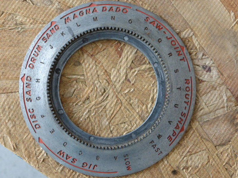

This shot shows why the Speed Control Handle will need replacing.
The teeth on the Speed Control Dial are pretty soft. Not sure if it needs replacing…
You'll see in these next pictures why I think the entire Speed Control unit will need to be replaced.
More to come. Thank you Gentlemen for your help.

Thank you Bob, He wants $21. for his and SS sells a new one for $29 although not with his stainless teeth. Do the factory Speed Control Handles break very frequently? I'll have to think about this one.
Bad news, the control sheaves are not moving after PB Blaster. Looks like the best solution is to take out the motor. What is the best way to remove the nut without it going balistic with the spring?

DMcCam wrote:Thank you Bob, He wants $21. for his and SS sells a new one for $29 although not with his stainless teeth. Do the factory Speed Control Handles break very frequently? I'll have to think about this one.
All the Best,
Dave
Fergit the price difference - his will outlast the mother ships one. You will not get 'yours' back unless you request it. If not you will get the replacement almost immediately(snail mail speed both ways).
Yes the gears strip all too often. The mating gear is steel. The original gears are aluminum. That said, mine is 60 yrs old and not stripped. If you do not force the speed control knob, the gears last. FWIW I would always go with the rebuild.
Think through the procedure from Beeg, but it includes switch removal etc. Ok since you will likely need to do that anyway. The nut is indeed a left hand thread. The board with a hole is not well described, but you will figure it out. The board allows depressing/holding the spring and releasing it slowly after the nut is removed. One end slips under the casting and you press on the other(long) end. Since you have an "A" headstock, the short end dimension may need to be different. Putting that nut back on may be a challenge - just persevere!

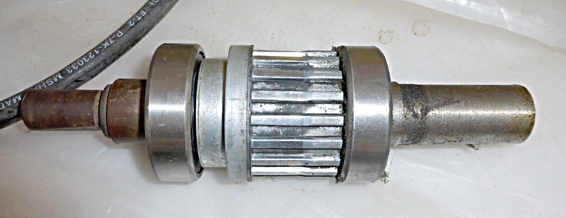

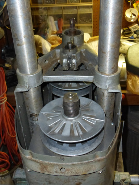

Hi Paul, I may not have an option but to upgrade. Here's a picture of my gilmer dive shaft. The bearings move very well but belt has worn a low spot in the gear with the belt frayed on the edges. Not looking good here.
The quill moves a lot inside the outer sleeve even though the bearing feels tight and smooth.
One good thing is that the motor runs very well and the idler Sheave moves freely. Is this motor original?
Inside it looks a little grungy. The belts have thrown bits to the walls. We'll see how things clean up.
