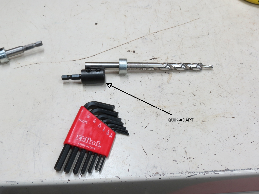

I have some dated step drills from various Kreg jigs. They have a standard drill shank unlike the newer drills with the hex shank. While shopping at a Menards store I saw an adapter called a "Quick Change Pocket-Hole Bit Adapter" and of course it was on sale.

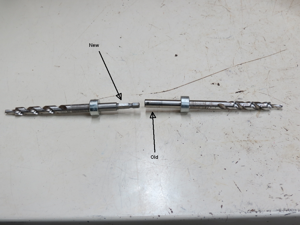

Today I had the time to check it out. This first image shows the two type bits I have. The hex is the new version and the straight 3/8" shaft is the old version.

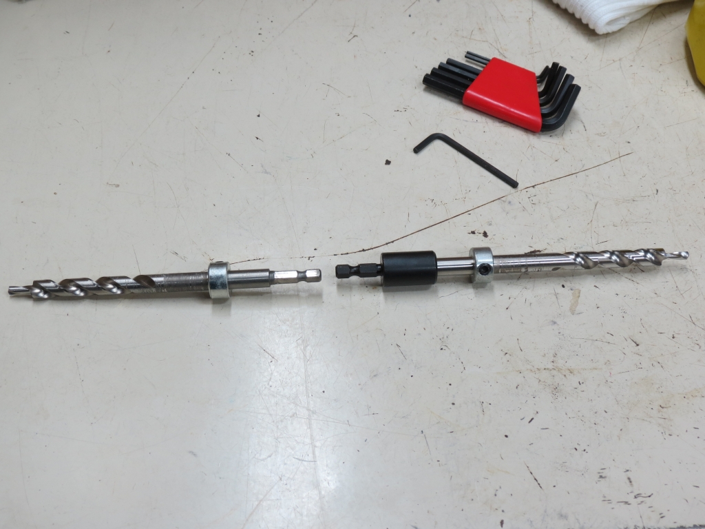

The adapter accepts the 3/8" shaft and locks it in place with two setscrews. The hex shaft now stays mount to the bit. Operationally it works just like the new bit.
This saves time because now you can use just one drill and quickly change from drill to driver using a quick change chuck. Or so the story goes.

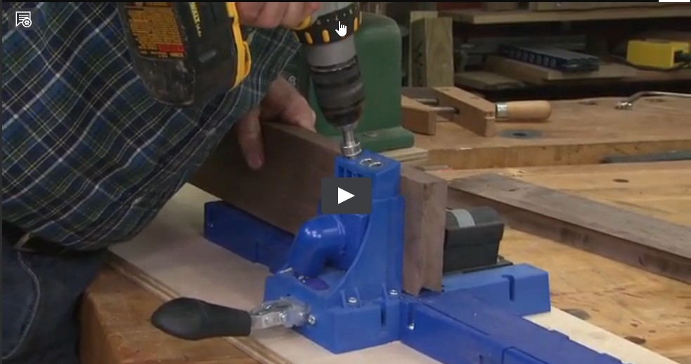

Hey Ed,
I don't catch all of his shows and since they are on PBS I'm not sure how new or old this one is, it is where he makes a drum. The battery drill is drilling the holes for sure in this one. I'd be interested to know if this is a fluke or if he now uses battery drills more often?
This is a frame of one I just happened to watch the other day.
