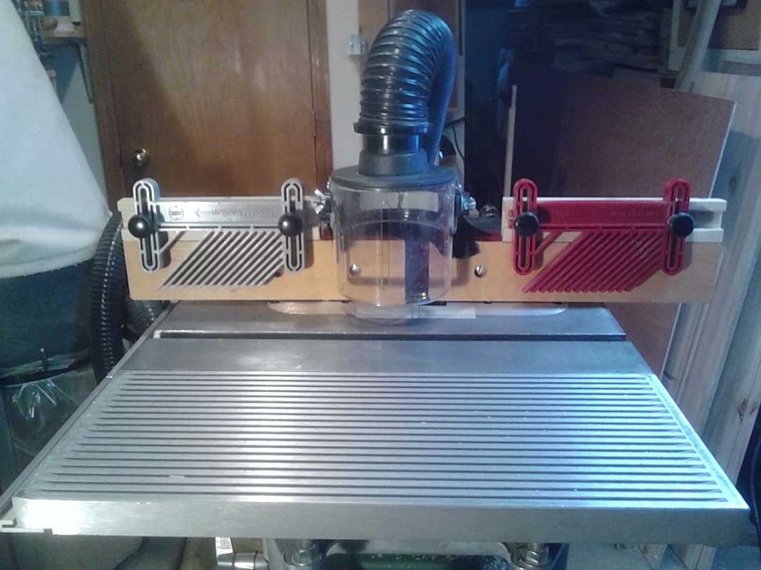

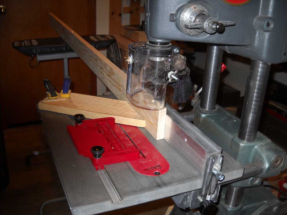

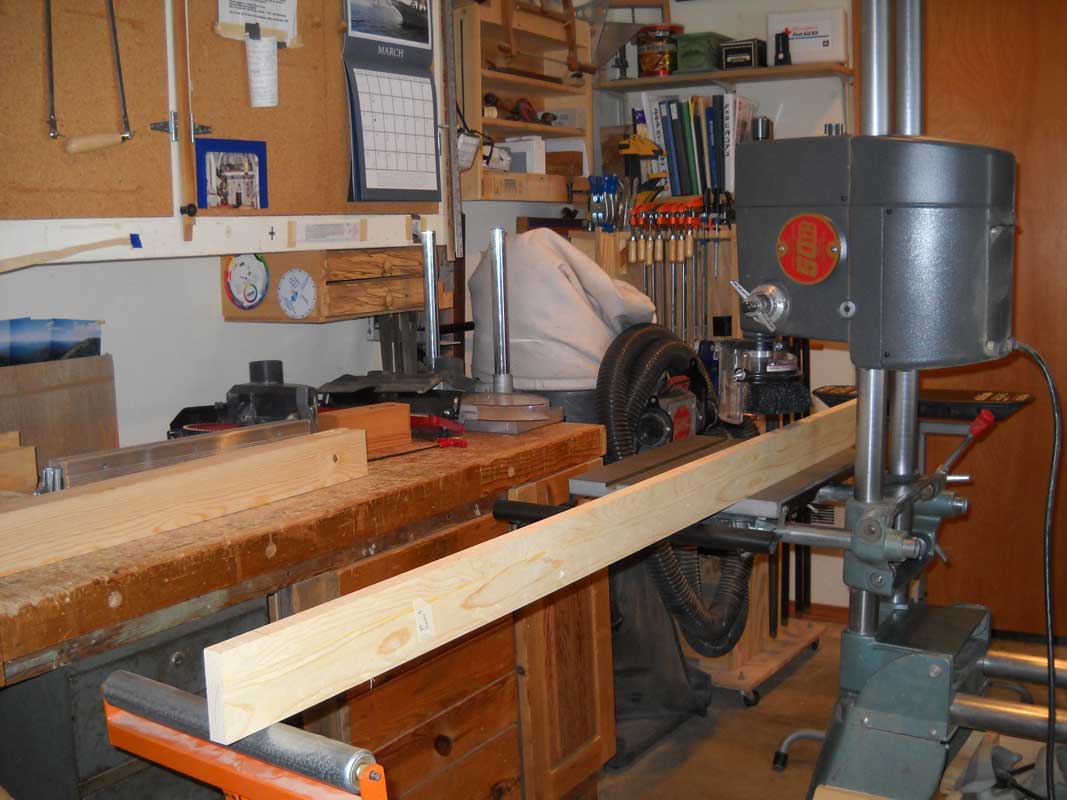

Now that is a neat idea, I like it. You are essentially using one of the stops like the "fingers" that turners use to determine the thickness of a bead or cove cut. The finger drops off the workpiece when the desired diameter is reached. Very cool. I think that would work really well, but I am not sure how I would mount the stops, though. I am attaching some photos of how the Shopsmith was set up to do the rabbets and you can see that I used the shaper fence with the add-on pieces to hold the vertical feather boards, leaving no way to attach stops that I can see. I wonder if I could have used a regular rip fence with a track that would let me use stops, to which I could have bolted an auxiliary fence of wood with a gap for the bit...hmmm...that might work. Thanks for the ideas.
This shows the fence I used and also the masking tape guide lines:
And to get back to the original point of this thread, I did recall that a year or two ago I made some cupboard doors that required mortises in long rails and I did use a spiral upcut bit and the SS in drill press mode. It worked great. I had forgotten I had done these mortises this way. I think this was the first time I had cut mortises by routing versus by drilling. I have to say, after remembering this, that it did work fine. I can't recall how many passes I made but the passes were somewhere in the range of 1/8 or so deep each time. Again, the question of how stops could be arranged in this situation comes up...I just marked the ends of each mortise and eyeballed the cut. No big deal when the mortise will be completely covered by the tenoned rail. The stops in the rabbets I cut last week will show, though, so stops for that operation would have been very useful.
