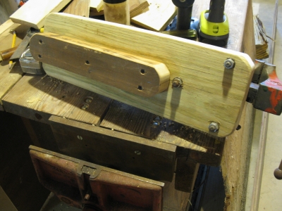

This one of those quickie little things that actually has more thinking in it than it looks like. Then again I was heavily medicated when I started thinking about it. :D
It's one of those things that you grab a scrap to whip one out because you are pretty sure that you will want to make changes to it right away.
This is for my bench to serve a few specific purposes and not many people (if any) would have a bit of use for it, but it will serve me.
It may be the only one in the universe. :D :D
I'll post this picture now then when I get a chance later this evening I'll post some more with an explanation. Don't hold your breath until then, most bird houses are more exciting. :)
Guess what.jpg (96.5 KiB) Viewed 2665 times

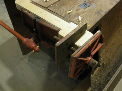

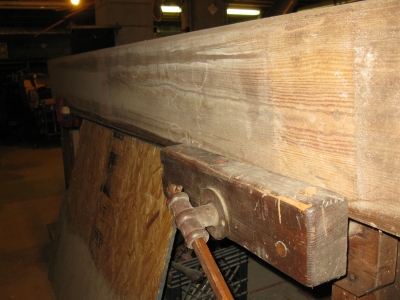

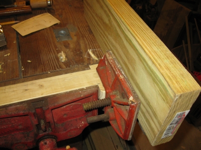

My old homemade vise is located at the right end of the main bench on the front. I know most guys like them on the left front but I like the right front. That corner is also closest to the door to the outside of the basement which has my only windows and I love natural light.
Some time back I mounted my large Reed vise at the left end but around at the end, not at the front. That bench sits out in the floor and I work all around it.
Here is the Reed vise.
Vise mount 2R.jpg (109.81 KiB) Viewed 2625 times

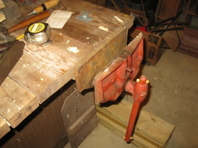

Here is the adapter mounted in the vise.
Vise mount 3R.jpg (102.21 KiB) Viewed 2625 times

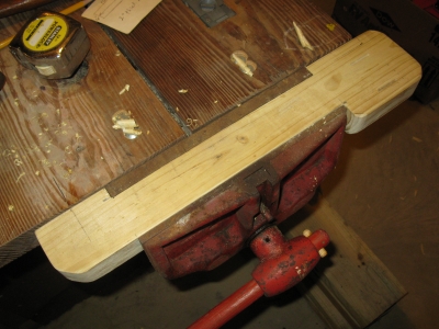

I do sometimes want to support a board on edge at the left end of the bench. I have this cute little cast iron vise that we used to have mounted to a sawhorse for remodeling jobs.
Vise mount 4R.jpg (94.67 KiB) Viewed 2625 times

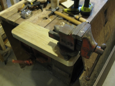

With it in this position I can clamp a long board (I often work with longer boards) upright in a vise at both ends of the bench at once.
Vise mount 5R.jpg (101.2 KiB) Viewed 2625 times
On the odd occasion that I want to work a board on edge up on the bench I can move the small vise a couple of inches to the left so the board rest on the bench top. Most of the time it will just hang under the bench.

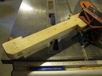

A massive change to the big huge complex project. ;)
I had thought about this to start with but didn't really think that it was necessary. Turns out that it is. With the heavy little cast iron wood vise hanging out on one end it can take a bit of effort to line the mount up with the big vise and have a hand free to tighten the big vise. So I went with my original plan and put a couple of dowels in to go into a pair of holes in the end of the bench that line the mount up properly so it supports itself taking care of the weight all being out on one end. Can you tell that I have just been messing around lately? :rolleyes:
Then I couldn't find my dowel centers... Still in a box someplace. :confused: Rather than measure and screw it up :rolleyes: I just clamped the mount in the vise and drilled all the way through the mount and into the bench. That way it "had" to be right. I'm sure the two dowels glued all of the way through the mount makes it stronger but then again I am also sure that it didn't need to be any stronger. :)
Anyway, it works just great.
Vise mount 7R.jpg (94.78 KiB) Viewed 2402 times
Tomorrow I will invent fire... :D

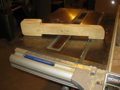

These are piddly little quick & dirty projects but I am enjoying doing a few of them because I have wanted to do them for a long time but just never had either the time or the energy nor the "round tuits".
When my woodshop was still in the farm shop if I wanted to bend a little piece of steel for something I just walked a few more steps and used one of the 5 or so larger metal working vises at several locations there or if I wanted to beat the crap out of something I could use the big anvil in the blacksmith shop. Several times since I move the woodshop to the basement I have wanted a regular vise to bend something or even just to hold a tool differently for sharpening. I have had the little vise in the picture for a long time and used to keep it on a smallish bench in our store. I "think" it was on a bench I got at an auction but I can't remember for sure.
Since I was on a roll I grabbed a couple of pieces of scrap and made this mount for the little vise. I expect it to get a reasonable amount of use.
Now I need to unmount the vises and clean them up well and paint them and also paint the mounts because if I don't do it now I may never get back to it.
Vise mount 8R.jpg (105.1 KiB) Viewed 2337 times
Vise mount 9R.jpg (93.65 KiB) Viewed 2337 times
Now I need to get busy making and installing mounts for my version of wall cleats and start getting some serious hanging up done...
