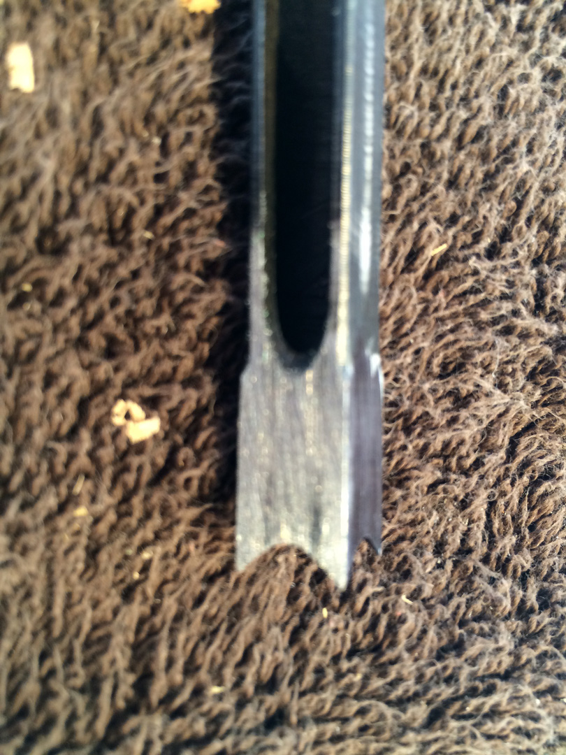

I got a Delta Mortising Kit from a friend with health issues :( and the chisels have a ⅝ inch shank as do the SS chisels.
So I thought to give them a try. I honed the insides with 2 grades of conical stones from Rockler and then tried to hone the outside surfaces. One can only hope that mine are of an ancient set before precise machining came about.
The outside surfaces are actually concave, to the point that I will have to back down to 80 grit to get them level. :eek:
The ⅜ chisel part number I am working with is 17-910 which Delta no longer recognizes so, Gene, I hope yours are more easily honed for use.

The Delta set that I got may have old chisels since I could not find the 17-910 (⅜ inch) on their website.
In any case, Gene, be very careful when sharpening the chisels. They looked fairly good but when I tried to flatten the outside faces they were all 4 warped. I am now down to 80 grit and here is the result of one face after around 50 strokes: (the black streaks are ink so I could track progress)
Delta 17-910.jpg (368.74 KiB) Viewed 7681 times
Obviously, I have not even come close to the clarity of Dusty's pictures!
Forrest

Thanks for the heads up, Forrest. I'll check the ones today that came with the machine....and the extra set, when it gets here.

Forrest,
Checked one side of the 1/2" chisel. It's not flat. That's enough for me. They'll all get flattened, now.
I'd have never thought to check them if not for your post. Thanks again, friend.
