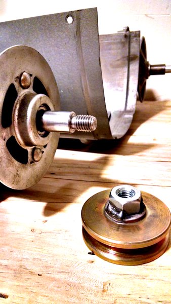

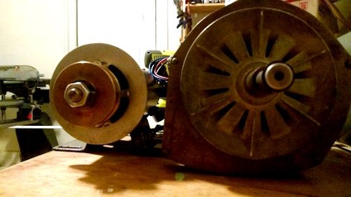

Chris - yes, it fits. Sorta. Smaller diameter than stock but a little longer with the attached fan on the back, though I can shorten that end of the shaft (it is oddly long). That way I'll just make a louvered extension on the motor pan that sticks out around an inch - won't interfere with anything.
Motors-Fan.jpg[/attachment [attachment=4]Motors.jpg

Turned out the pulley isn't appropriate as is.
It is spot welded to the nut so that it doesn't turn, but there is nothing to keep the nut (and pulley) from spinning off when run in reverse (which is the normal way for SS, as this motor runs the other way stock). The shaft is .67" or 17mm, luckily standard for alternator shafts, though there is no keyway etc.

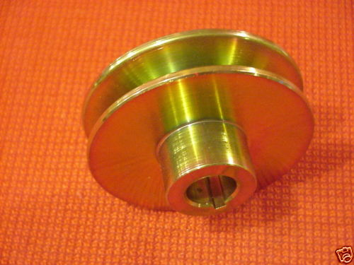

I just purchased a replacement:
. I'll be able to drill and tap it for a set screw and grind a flat on the shaft. I can also grind a slot in the shaft for a key though I hope to not have to bother. I also got a stop collar, thinking I would just use a key and capture it between the stop collar and the nut, though I'd like a simple set screw instead. I also checked the minimum pulley diameter for A size link belts and this is it: 3.1something. The other was too small, and 3/8 instead of 1/2 wide belt. I figure I'll start with HF purchased link belt to get it all set up, then switch when I know the size so I can conveniently use reverse.
