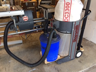

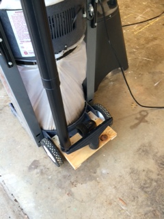

I have been very pleased with the SSDC3300 system but I was concerned when cleaning the floor about damaging the fan with large wood chips or even screws that may have fallen on the floor. I solved this problem by mounting a Dust Right Separator from Rockler,(http://www.rockler.com/dust-right-dust-separator) in front of the DC3300. The separator sits on a plywood lip that I bolted to the pan of the DC3300. Also I mounted a plywood lip on the back of the pan to hold DC tools. No more worries about damaging the fan plus now I have a container that is easy to clean out without having to remove plastic bag from DC.
- Dust Collector in front of DC3300.JPG (41.95 KiB) Viewed 25665 times
- Tool Ledge on DC3300.JPG (51.89 KiB) Viewed 25665 times

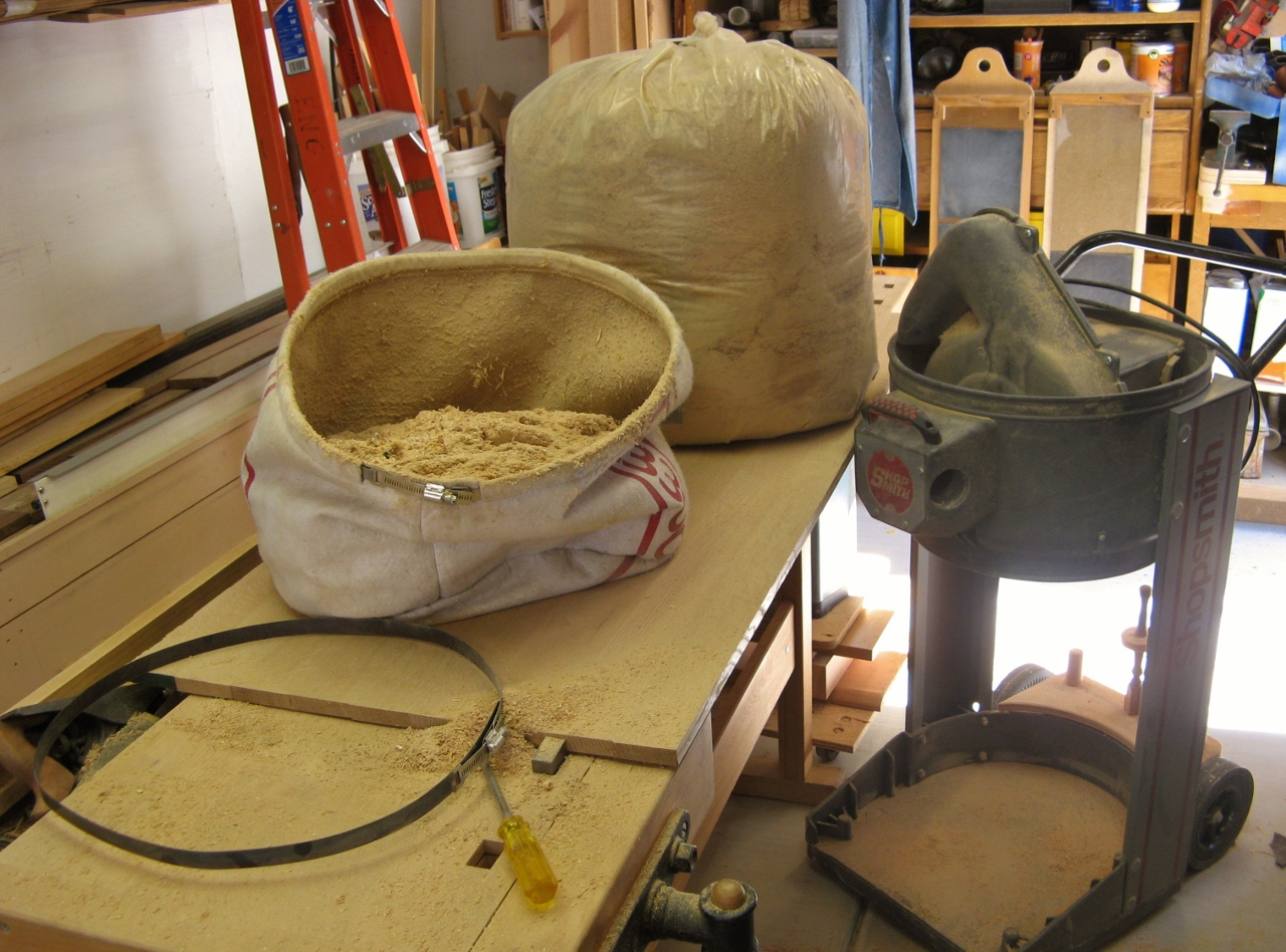

I have bought more SS equipment than will fit into my small overcrowded work space. I was tired of always dragging the DC hose around, walking on or over the hoses. So I built an enclosure that made space to put something on top of the DC. I also ran the hoses over head and put closing gates at the end of the hoses. It works OK but don't expect it to look like a TV woodworkers sawdust free shop.
Experience = knowledge gained to late
Now for my experience. The way the enclosure is made it's difficult to connect the hoses so when the suction became a little weak I chose to ignore it and check on it later. Well when later came the suction stopped completely. The exhaust hood was so packed with sawdust that when I removed the bag the sawdust stayed in the exhaust bag and didn't fall out. The pictures tell the story.
PS: Never take the exhaust bag off without turning the DC upside down.

James. How is this setup working for you after a couple of years? Any suction loss with the separator connected? Is there roomJamesT wrote:I have been very pleased with the SSDC3300 system but I was concerned when cleaning the floor about damaging the fan with large wood chips or even screws that may have fallen on the floor. I solved this problem by mounting a Dust Right Separator from Rockler,(http://www.rockler.com/dust-right-dust-separator) in front of the DC3300. The separator sits on a plywood lip that I bolted to the pan of the DC3300. Also I mounted a plywood lip on the back of the pan to hold DC tools. No more worries about damaging the fan plus now I have a container that is easy to clean out without having to remove plastic bag from DC.
To actually sit the separator under the fan and shorten the bag since most of the dust should be collected in the separator? Looking to try this setup. Thanks.
