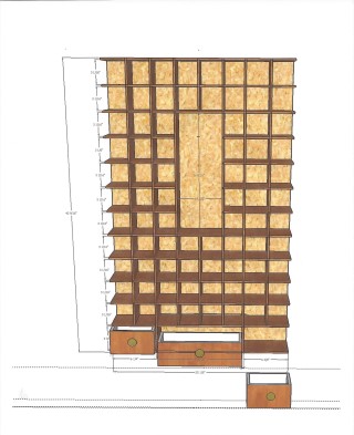

As the committee looked at commercially available cabinets I realized that this was something that would have to be custom made and volunteered my services. I came up with a plan using Sketch-up. From Sketch-up I drew full size plans on brown butcher paper then went to work.
TonTine Cabinet Interior Scan (Mobile).jpeg (29.6 KiB) Viewed 2000 times

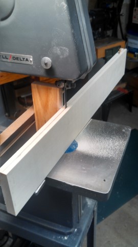

Cut to finished lengths in 3/4" it was then resawed on the bandsaw.
IMG_20141205_143332_552 (Mobile).jpg (56.31 KiB) Viewed 2000 times

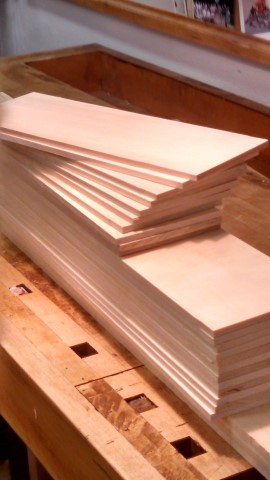

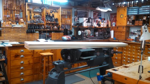

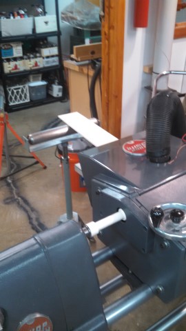

After resawing the Aspine was brought to its final 1/4" final thickness using the SS planer.
IMG_20141205_160817_665 (Mobile).jpg (68.49 KiB) Viewed 2000 times
Finished wood.

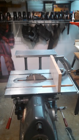

I set-up my SS Mark 5 with a 1/4" Dado blade and jig to cut the slots to create 4" cubby holes. I found that 4" gave the shot glass a nice amount of finger room. It also allowed for 77 cubby holes plus a drawer.

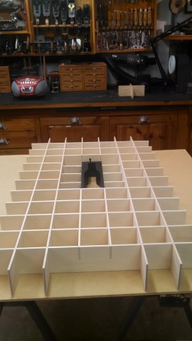

It didn't take long to put the cubby holes together. It is important on a project like this to begin with the interior and build the cabinet around it.

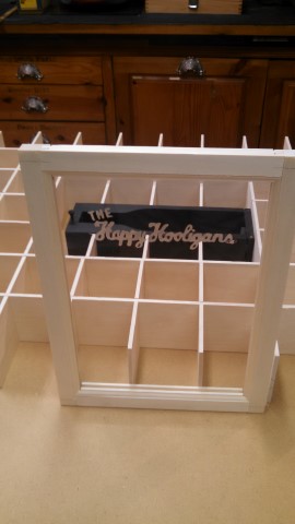

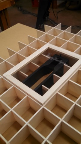

I decided to place a door over the Cognac compartment with a glass etched with the The Happy Hooligan moniker (which had it origin during WWII with members who flew F51s in Europe). I did the etching and was pleased with the outcome.
IMG_20141208_165623_238 (Mobile).jpg (51.32 KiB) Viewed 2000 times

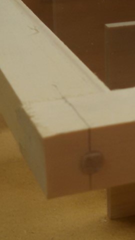

I molded the stiles and rails and fitted the corners with dowels to support the weight of the glass.

I noticed you indicated that you molded the door stile and rails. Did you use the Shopsmith molder head for this operation or another brand?
WmZiggy
Posts: 487
Joined: Sat Jul 22, 2006 4:11 pm
Location: Horace, ND
Re: Tontine Cabinet Part 1
Post by WmZiggy »
I have a SS shaper with a speed increaser tool. I also have a stand alone Grizzly 1/2" wood shaper. For all of the styles and rails I used the Grizzly. I have a better vacuum pick-up on the Grizzly. One of my complaints about the SS is that it throws a lot of cuttings down and the overhead fixture doesn't suck them up. The SS w/o the speed increaser in overhead shaper mode and vac plugged into the hole insert does a nice job. I have two Mk 500, so maybe the new ones do a better job on dust pick-up in shaper mode.
