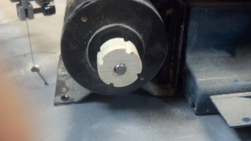

OK, this is how it turned out. as a temp set up, I made a wood drive hub...
Wood Drive Hub (Custom).jpg (56.18 KiB) Viewed 4635 times

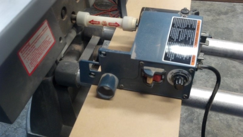

Lined it up...
Temp Mount 2 (Custom).jpg (71.62 KiB) Viewed 4635 times

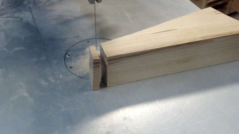

It cut a 1 1/4 thick piece of hard maple no problem.
1.25 hardmaple cut (Custom).jpg (59.56 KiB) Viewed 4635 times
BUT, the gear ratios in the saw cut the strokes way down. The motor runs 400 - 1600 when hooked up as a direct drive but the saw was cutting at about 2 strokes a second on 400 and around 8-9 strokes a second on 1600. Lots of power. I'm going to see if I can set up a 4 to 1 pulley or gear drive and make it work. I like how square this saw cuts without a lot of adjusting compared to my Dewalt but running it off the Mark V power head is way too noisy.

BTW it doesn't seem your speed (the movement of the blade) is too low. If it works this way why not stay with it, at least for a while. I haven't slowed my PowerPro down to 250 or 400 RPM to see the effect on blade movement, but will do so later.
Just checked the recommended speed (on the PP) for hardwood and a skip tooth blade. It is 2080 RPM. This seems pretty close to the 1600 your system has at the moment.

Charlese, I was thinking the same thing after posting last night. That block cut much better just above the lower setting than at high and the #5 blade I used didn't get hot, which is always good. I'll finish it off and play with it while I get some gears made up.
